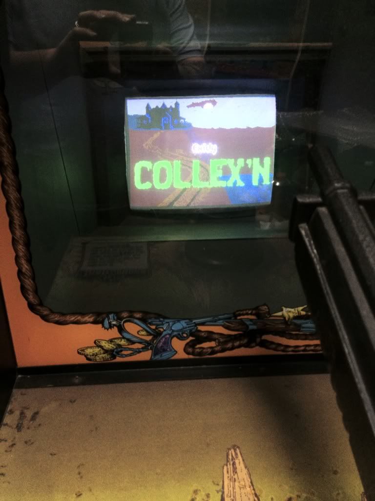

Finally a day of triumph. After over two months I got a phone call last week saying my board was repaired. Also got this in today:
Unpacked everything and I put the boards in and no dice.. I then tore all the wiring out and noticed that some of the wiring on the power line was chewed up by mice and there still was some mice crap behind the pcb cage. So I cleaned the cab up more, rebuilt the main power harness pulled and checked over every connection, reflowed all the solder points on the linear cap board and replaced some of the connectors that looked a little dirty and or burnt also replaced the switcher that was in there and...
Success!!! I was a little confused though as I didn't realize some of the games in the menu weren't playable. Now I need to finish restoring the cab and replace the speakers as they sound blown.
Finally played chiller again for the first time in 18 years. I love that game. Now to get my warlords up. Trying to have a productive week in the room.

I asked when they called but the girl didn't know. I think some of the memory burnt from what she explained and I noticed they had replaced the power connector on the board. See the thing is, the machine was doing the same thing (blue screen) when I put it back in the cab and only after I redid the wiring/connectors on the main power line did she boot up. So I think a voltage snafu on my wiring caused some of the board to fry. Like I noticed some of the sounds in Chiller including the scream for the menu don't work but everything else works.
Also to note, the 5v line on my game was replaced with a switcher and not the internal linear 5v wiring. The other two voltages +/- 18 or 22 or whatever were still there. So my wiring was modified a bit. Hope this helps.

Now i know that if you use a combat board you will be missing sounds cause the combat isnt stereo. all cimbat cabs have 1 speaker.. to make it stereo you nred to add another speaker and run the wires to the pinout lwith the crossbow pinout... As for cheyenne make sure you jave another speaker in that cab... cheyenne cabs are the same as combat.. dont let the screws on the speaker grill fool you in thinking there is a speaker.. open it up and phyiscialy look to see if there is 2 there...
Checked and there are two. I still think its something else as I get rom errors and some sounds are replaced with chirps. Mind you I replaced all the roms on the multi so it has to be something else on the board.
