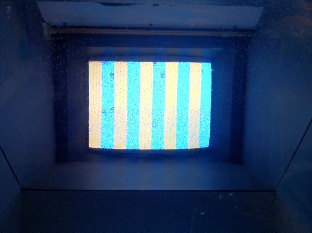

Cheyenne with multi-exidy blank/screen bars.
So I had a working Cheyenne that I put the multi-exidy. Now I'm running a blank screen or yellow/blue jailbars. I checked the voltage and there's a huge drop across the board. not sure if this is normal. Anyone have advice or repair exidy boards? I'm mildly frustrated and at a loss.
Went back and fiddled with the dips as widel.com is down and had to use googles cache of the site.
Got a dip error then a nvram error and now back to bars.
Any help?

Yeah, I've noticed a few threads as well but no definitive answer. I also noticed that the voltages were turned up pretty high on my cab. The switcher was turned up to 6.3-6.4v but was showing 5.2v across the 74xxx's on the boards. It was a pretty huge drop and not sure if it's normal. The -/+18v was running in the 21.2v range on both legs, not sure if this is normal but cheyenne ran.

I have some experience with these issues. One common failure with the Exidy multi board is either bars or the dreaded 'NVRAM error' screen. As you have indicated, this can be a voltage issue. If you check to see what your logic voltage is at the NVRAM socket, I bet you are below +5V there.
From what I have seen, a board that is functional without the kit can have voltage problems when a kit is installed. At this point, the extra connections to the new daughterboards can allow for another voltage drop, etc.
There are a few ways you can go about suring up your voltages. I would check for cold solder joints on the interconnect pins that connect the sound board to the logic board. These interconnects are available at pinball parts sites. Reseating/repinning the molex connectors coming from the power supply to the CPU board has also helped me.
A more extreme/permanent measure would be to run some jumper wires around to boost the +5V logic level in places. That is probably a safer bet than running the +5V too high on one end of the board in order for the appropriate amount to trickle down to the other end of the board.

I think there's definitely a few compounded issues. The voltage drop is something fierce across the logic PCB. (1-2vdc) Also the 18v lines on it were up to 21v. g3n, is this the same on your game? I believe there's some adjustment in the encased portion of the PSU outside the switcher, is that the 18v adjustment? But yeah, the switcher PSU was putting out 6.4vdc at the lugs and somewhere around 5.2vdc with the regular chips installed and 4.3vdc with the multi kit installed.

I have fixed several boards with this problem but it is never exactly the same thing that causes it. The 440 boards have problems distributing the +5v line. It will be good coming in but on the other side of the pcb or at the roms in this case it will be very low. This is why you see them with the switcher cranked up to over +6V sometimes or burn marks on the main power connector of the pcb. Many times it is bypass caps as mentioned earlier or just cracked or cold solder but it can also be a combination of things. I would check the voltage at the roms and ram to see if they match what is coming in the board and go from there.

Taking into consideration the age of the game and also that I wanted to take a little chance, I boosted the voltage at the connector to the PCB to +5.11vdc and read +5.06vdc at the ROMs.

I began reseating the ROM's by partially removing them then pressing them firmly back but noticed a couple of items which then made me take the long route and proceeded to pull, clean, straighten pins on ALL socketed IC's, EPROMs, ROMs, BPROMs, RAM and misc. Logic IC's - DAMM there's a lot of 6116's!
Found some really dirty EPROM legs some of which look like they were reprogrammed several times, (look beat). Found some bent legs and a really bad leg repair.

I installed the boardset and fired it up in test, start button closed and I got the "start-up" sound as before but now the displays bars, instead of just being a shade of blue, now appears to have all the colors scattered throughout, pixels of red , green and blue. I also got another audio byte, I do not remember exactly but it went something like, "you are all going to die".
