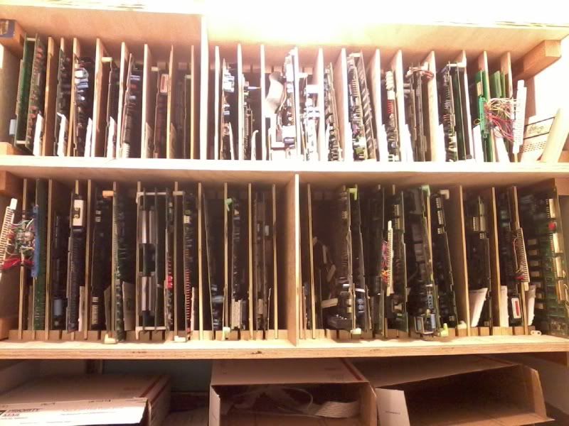

So, last week, I came to the conclusion that usps priority boxes wasted too much space when it came to pcb storage. So, I thought about making a shelf system that would allow me to store pcbs in an upright configuration and would allow for various sizes of pcb. I think I did a fairly good job accomplishing what I set out to do. With priority boxes, I could fit 12 games on a shelf... Now, I have 21 on the lower and 18 on the upper with a couple empty slots left. Total cost of materials was around $100 from home depot with enough left over material for one or two more shelves.

The last pic with the pcbs in ;)

Do you plan to set the pcbs into the empty pockets, or mount them to the dividers so they slide out one at a time?
The slide out version would look neat, but you'd need a bunch of stand-offs and the boards would likely warp over time with weight hanging off one side only.

Haa haa! I have 3 CPS2 boards stacked inside my cabinet sitting on a upside-down bin. There 4th is mounted on the side. Then I will set whatever game that is not CPS2 on top of the stack. I need to snap a photo of my crazyness.
Well, that looks pretty nice - if you are planning on filling it with Centipede or Missile Command PCB's. Won't have much luck getting some 2- & 3-board stacks in there unless you remove a divider...

you can actually cram 2 next to each other in the spider-man cab (any cab with 24" of inside width) without the mounting feat.

I think i figured it out to about 5-6" between each sheet of wood in my Spider-Man to maximize game space (enough for a cps2 or multi-level board set or 2 single boards facing each other).

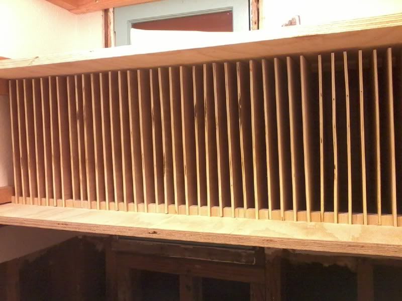

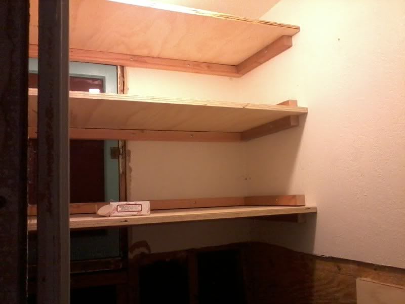

Ok, so here's the run of pics from photobucket.
All the dividers are removable to compensate for multi-stack boards (which most are, it seems). Basically, the shelves have 3/4" cubes nailed 1/4" apart in two rows on the bottom, and one row on the top. Then, I used 1/4" tri-ply boards as dividers to support the pcbs vertically. The shelves are held up by standard 2x2's of which I pre-drilled the holes, and screwed into the studs of the walls with 3 inch cabinet screws with large, flat mounting heads. The shelves, themselves, are made of 3/4" cabinet grade birch plywood. This is a very small closet, so a test bench in here would NOT really be comfortable... or well ventilated. I was thinking of building some doors at a later point, but for now, I'll leave it open... I plan to build these shelves from floor to ceiling (not all with the same dividers though).
