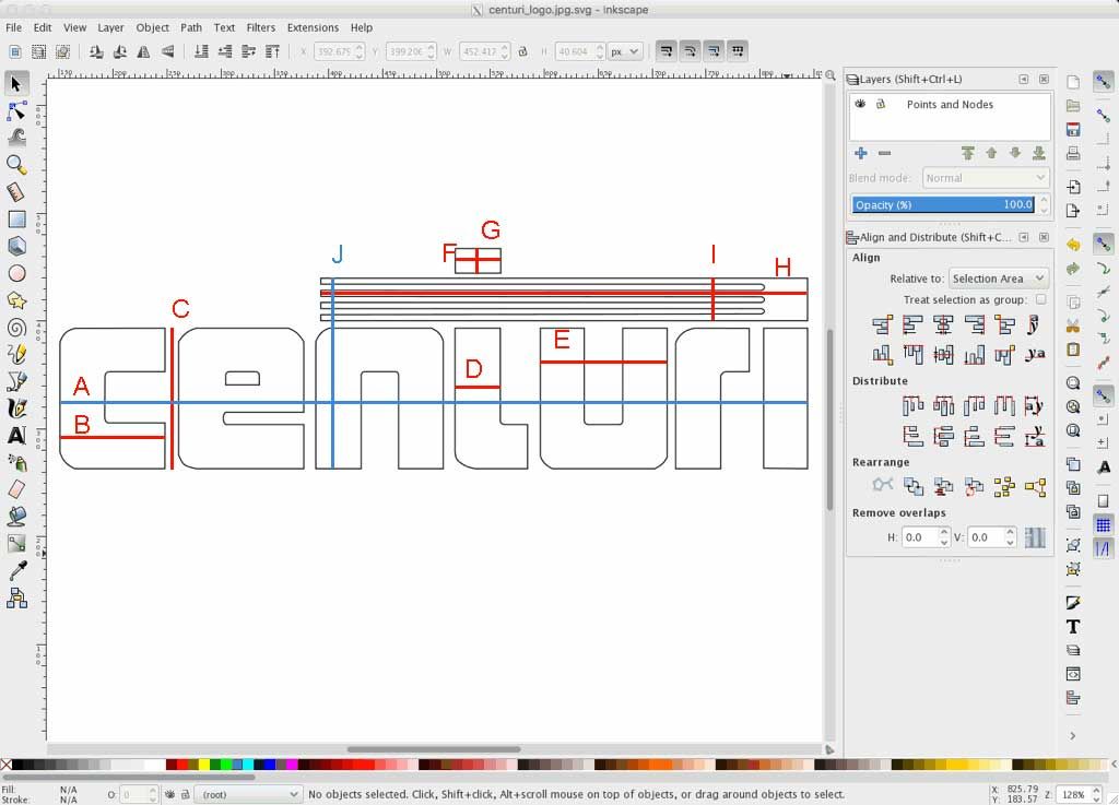

I've been doing a Track and Field cocktail scratch build. One detail I'd like to have is the raised Centuri badge that's attached to the coin door. Because I bought a new coin door, I don't have said badge.
I thought maybe I'd try my hand at making a reproduction because I don't see anyone selling these. My current plan is to make a model and make use of the 3d printer we have at work to see how close I can get with that and some paint.
So far, I've taken some images other people have posted and I traced over the images with nodes and lines to make a Scalable Vector Graphics (SVG) version. It was a huge PITA, but it looks nice so far (I still have to add the registered trademark R).
Next, I'm going to import the image into TinkerCAD or some other suitable program and make it three-dimensional.
Honestly, I don't think I've ever seen one of these in person, so I'm not sure how much the letters need to be raised up. If someone would be willing to share that information with me, that'd be great.
While I'm designing this to fit my coin door, if you could post some other measurements, like just take a picture with a ruler or something, I will also try to make a true-to-original CAD drawing too.

Hey there,
Here's the letters measured. Your pic is amazingly close. I traced it using a rubbing with pencil as it seemed the simplest route. All measurements in mm
A) 146mm
B) 20mm
C) 25mm
D) 8mm
E) 24mm
F) 8mm
G) 4mm
H) 95mm
I) 8mm
J) 35mm
If you need others or feel i messed anything up, yell!

I am referencing mine and it appears to be a 1mm raised platform (its got a beveled edge) and then the logo is another 1mm raise (height) from the platform surface. What it looks like you are missing is the platform dimensions. And then the overall dimension.thickness of the full faceplate itself. If you were put a 1.5 mm perimeter around the logo and bevel it, you'd pretty much have the (footprint) dimension of the platform.
I have a separate drawing where I've roughed in the platform dimensions. Because my coin door isn't an authentic Centuri I was hoping to end up with two CAD drawings: one that fits my more generic coin door and a second that is hopefully true to the original.
Spent some time on the scaling tonight. The measurements were very helpful. Here's an animated gif showing the tracing overlaid onto the image I traced...the spacing is better and now I know it's to scale. I need to trace in the edges of the raised portions and then convert it to a CAD drawing. I'll post again when I have something significant.

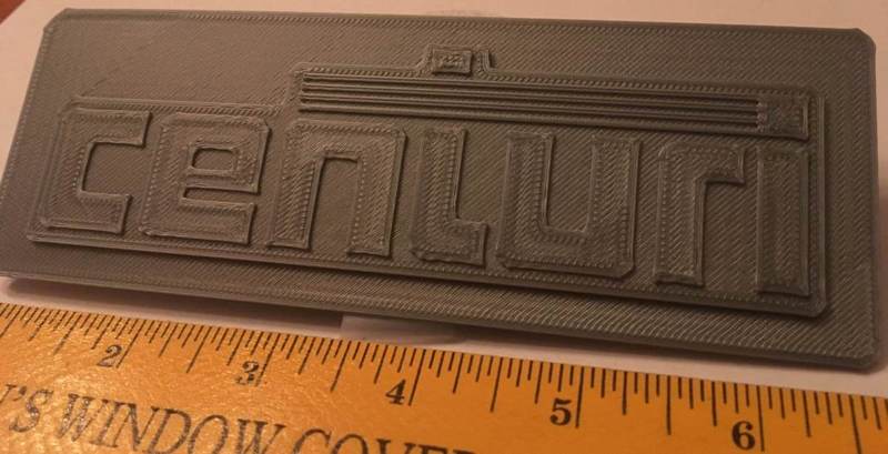

3d Rendering Done
Well, it took me a lot longer than a week.
I took my files into the maker store at our mall. I exported to every file (I thought) I could and none were the right one. Then it turned out there were some issues with my rendering that I had to fix. Finally, I got all that done, and the guy never replied to my emails. I ended up shopping it out to a guy in AZ. $15 with shipping. Not bad really, and I got it today.
Here are the pictures. I'm really happy with how well it came out for the first attempt. It's just a little too big to fit into my coin door, and the (R) registered trademark didn't print at all for some reason.
Assuming it doesn't cost a fortune, I'll get one milled out of aluminum once I get it tweaked out.
