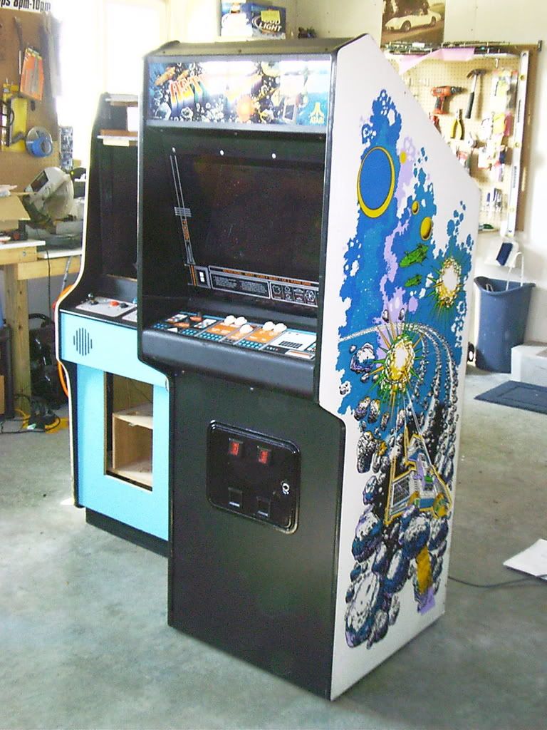

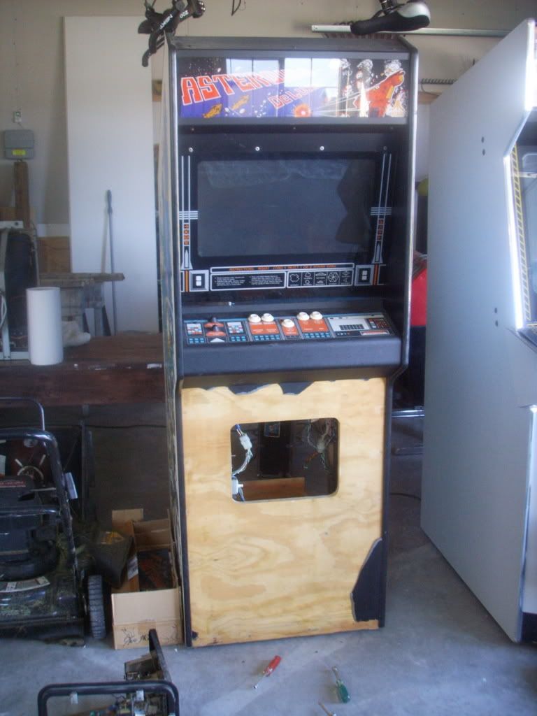

I did Black Laminate on my Asteroids Deluxe kickplate, as that was what was original on my machine. You can see it chipped and broken here:
and after:
I too waited til the laminate was set on the machine to cut out the coindoor. A router or laminate trimmer works wonders. Yes you do have to custom order the black laminate in most cases, though you can order a 3x5 sheet instead of 4x8 if you wanna save a few bucks.
