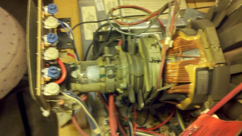

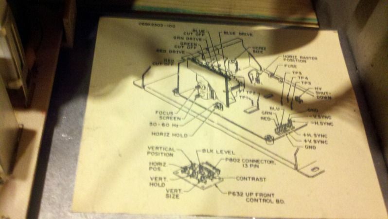

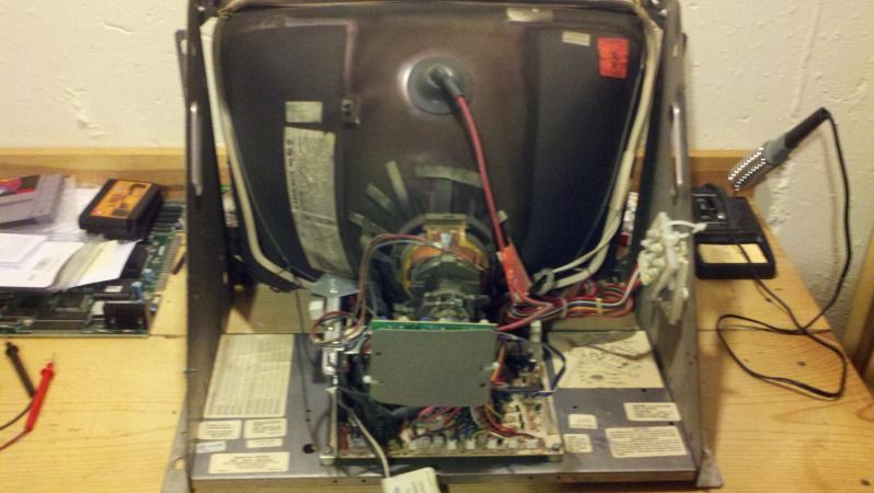

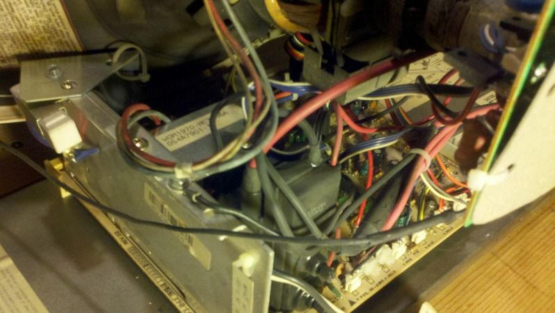

Sorry for all the delay, I've been busy. Here are some pictures of the monitor in question:
Also, before I took it out, I did a closer inspection. When I turn the game on, the picture comes up crisp, clean, and stable. It looks beautiful. Then after about two minuets, the picture disappears. When this happens, the marquee restarts like it's had power cut to it but I had a game going and the sound FX where not interrupted in that current game. There was no neck glow on the monitor after this and you could hear the static fizzle like you normally here when a CRT is turned off. What do you guys think now? Thank you very much for the help so far. Without KLOV, I'd be lost.
You've got yourself a K7000 with what looks to be factory caps on the board. The shut down is either cold solder or bad caps or both (I'm guessing both). The Flybacks and part of the B+ rail are notorious for having cold solder on those things.

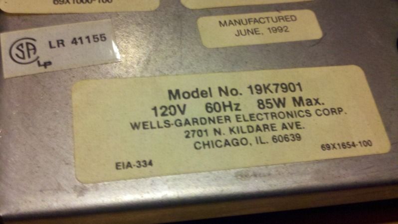

Centipede / WG K7901
Ok so I caped the K7901 in my Centipede and checked for cold solder joints but the issue persists:
I started the game up and after about 3mins the screen went blank but the game still plays blind. I turned it off and then on again and the screen stayed up for the rest of the night until I turned the game off (about 2 hours). I turn it on this morning and it goes off after 2mins. When the screen is blank, there is no neck glow. When the screen is on the picture is PERFECT.
