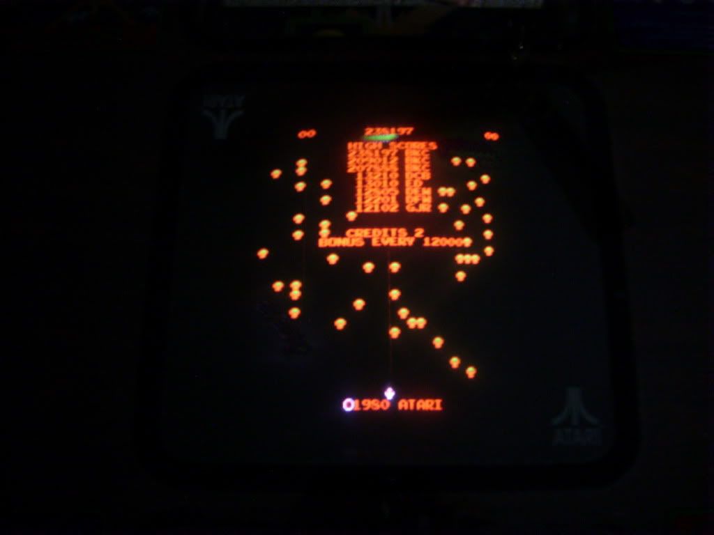

Well I finally made time to work on my Centipede Cocktail that I got a few months ago from a warehouse. Special thanks to Dokert for the ARII board:)
The G07 Monitor was a bitch. had a broken neck board. I had another neck board, but the way they attached the wires to the main chassis sucks!! The wires are wrapped tight around pins. Whats wrong with a simple plug??:confused:
Anyway there was no way to connect them back the way they were connected, so I soldered the wires in.

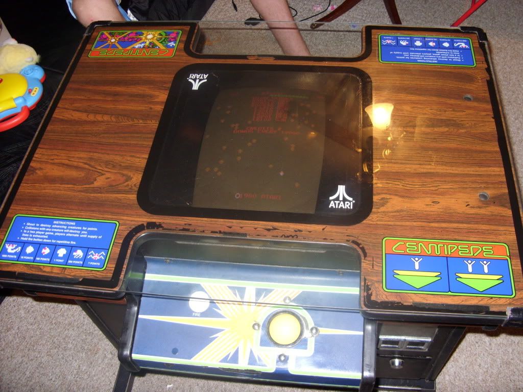

Man this machine is Sweet. I will be rebuilding the control panels next.
Thanks it made my day, not sure what to do with the underlay. Its all perfect except the ouside black border. Would it look stupid if I just tried to remove that outside border?
Is the border on or under the glass? I bet you could tape it off and paint it over and have it looking new. - Barry
