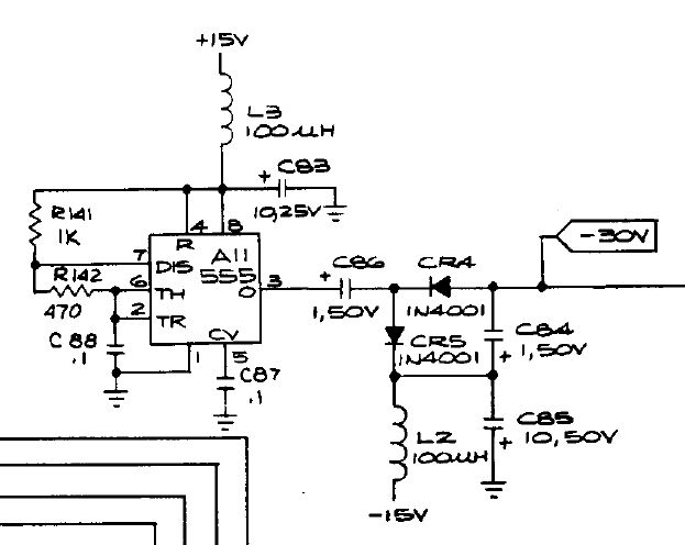

Okay I've checked and checked the soldering I don't know how many times over. I've metered all the connections and made sure the socket is installed correctly. FWIW nothing has changed since I added the socket. The original LM555 still works exactly as it did. I'm taking this out of the equation.
Out of all the metering and looking at all the sims the two things that stand out are:
1. Low 7v on the 555 output. I think it should be higher than that as per all the sims etc.
2. Pins 1GND and 2TR don't connect directly to GND or pin 6 as shown on the diagram. They do ohm out to ground at 30k which seems quite high.
I'm left answering two questions:
1. Why am I not getting -30v
2. Why so far have two new NE555's blown up on install.
Now I'm actually thinking about jumping the 555 pins 1 and 2 to ground or at least to pin 6 as per the diagram, am I crazy? Can I take this schematic that literally for my board?
Well I stuck in another NE555 but this time I grounded pins 1 and 2 as per the schematic. The voltage was at -26v which is much better than the 14 or so before with the NE555 and it didn't burn up either. The screen however was dancing all over the place and it wouldn't go into test mode, also the coin solenoids were clicking here and there. As soon as I disconnected the ground jumper the voltage dropped to -14 and the chip blew. Maybe they're not compatible.
Make sure you have the latest schematics. It sounds like you have an older revision.
In the DP-182 1st printing, pins 1 and 2 on the 555 are grounded. However on the 5th printing, pin 1 goes to ground, but pin 2 has a 0.1uF cap to ground (C88), and there are a couple of additional resistors.
Just search google for the right ones.
Great idea, just checked now and I have the older rev board, no extra stuff or C88. Maybe the this older revision board never actually went to -30v. Clearly there was some sort of an issue to warrant a revision.

The 2055 EAROMs used for score saving on all of these Atari boards are the same and all need roughly -28V to program. It can be a little higher or lower, but -26 is on the low end. The difference could be due to other components, but I can't say for certain, as I haven't actually measured many of these Centipedes, and can't say if the schematic changes matter either. (I know on vector PCBs, it's always -27 to -29V, unless something is wrong).
It appears that my board is the -01 version. Couldn't find the layout letter though.
My Sheet 1 schematics are 182-01 1st printing. Sheet 2 are 182-02 2nd Printing. They visually match my board from what I can see, the 555 section most certainly does for the exception of pins 1 and 2 not going directly to ground which doesn't match any schematic that I've seen. The other revisions that I can find in respect to the 555 section are either mine or the one you mentioned with the extra bits which mine certainly is not. I'll keep searching for different versions.

So looking at the schematics again, it looks like both of those caps are just meant for preventing glitching. We've seen these mods on other boards before (I forget which, but we discussed it in some other thread recently), where they didn't end up being added to the formal schematics, so it was likely they decided they weren't needed.
This is very likely the case for the H3 cap, which you can probably leave off with no issues. (If it is causing issues with the cap there, I'd suspect the cap being bad, as it's supposed to be 390pf, which is very small, and is only meant to filter out high frequency glitches.
For the 555 cap, that one looks to be connected between pins 2 and 4. Pin 4 is ground, and pin 2 is the '1V' signal, which is one of the timing signals (which is probably why your sync is getting screwed up). Again, I'd be suspicious of the caps first in these cases, if they are causing problems.
As for why you aren't getting the exact voltage, I'd next suspect the other components in the 555 circuit. Perhaps C84/85/86 are slightly out of spec. But again, you'd need a cap meter to check them, or just swap them out.
Or, perhaps CR4 or CR5 are marginal. They're just common 1N400x diodes, so you can try replacing those as well. That's about all there is to the circuit.

The output off the 555 (pin 3) on my machine is only 7.29v. All the sims that I have built seem to have an output of 13.5 to 15v. There's a -15 coming into that end of the circuit so my thought was that there should be a +15 to get the -30v. Am I off base with this train of thought? I can't see how else that circuit would make -30v.
Okay so I replaced the original LM555 with a new LM555 (not a NE555) and it didn't blow like the NE555's did, clearly even though they're stated as being compatible they aren't in this circuit like you stated before.
The voltage however remained at -25.43v and it still had an output of +7.29v on pin 3. I think it's safe to rule out the 555 and blame the missing -5v on the circuit. If we agree that the output of the 555 should be higher than +7v and more like 15 then that isolates the issue before the 555 right? maybe the reset line or something. The voltage going in is at +15v where it should be but I'm not 100% on the idiosyncrasies of the 555 chip.
