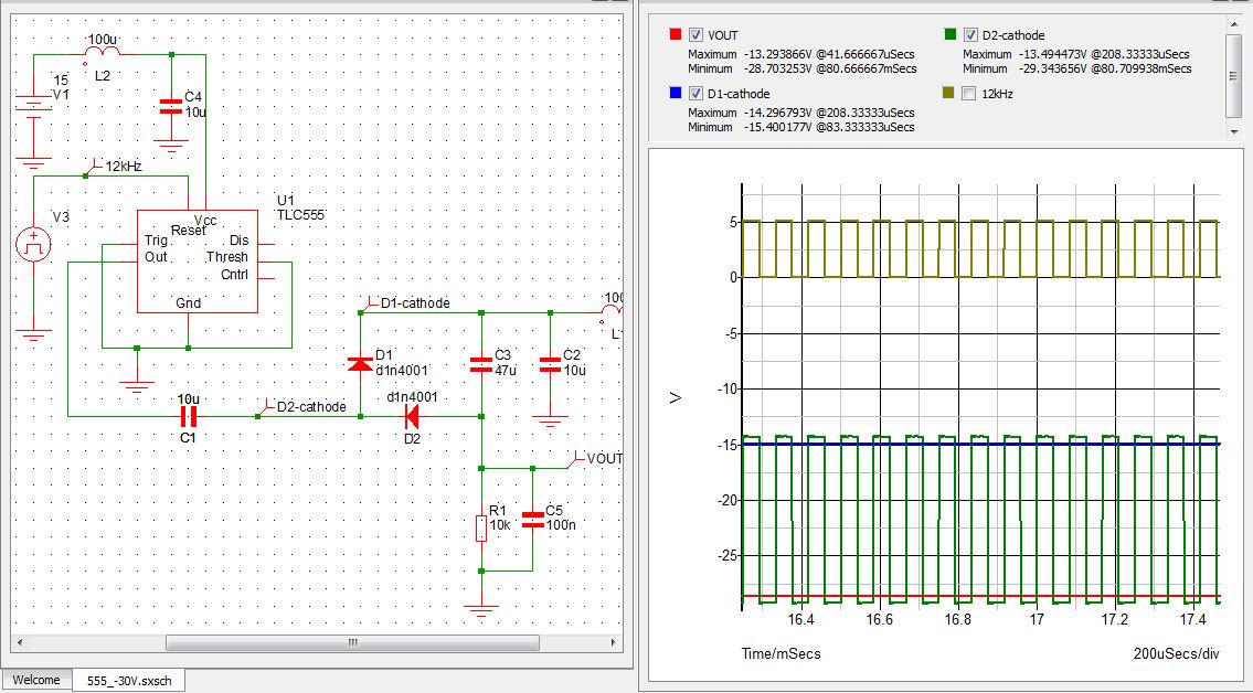

Well this was interesting and smelly. I changed out the Pokey, need to wait for a bit to see if I lose audio again.
The -30v however didn't change and was still at -25. I swapped out the LM555 for a NE555 and the -30v test point dropped to -16v and pin 8 (Vcc) on the 555 slowly went up in smoke with one beep (H2 Ram Fail) on start up. Stuck the old LM555 back in and back to normal with -25v and no smoke and no beeps.
Looking at the data sheets the 555's should be replaceable?? I did use a socket so can easily try another NE555 but figured I'd check in first.

Same thing happened with a known good NE555. -30v went down to -14v and it got hot. Turned it off before the smoke this time. Checked the configuration again as well, pin 1 both the same place.
This is strange.

Okay so checked all the voltages and labeled the schematic image. More importantly I checked all the connections and determined the following:
4, 5, 7 go nowhere as they should.
8 connects to +15v.
3 connects to C86.
Here's the strange part...
6 goes to GND as it should.
1 and 2 are connected together via trace and should also go to GND as per the schematic but do not. There aren't any traces on the board to take 1 and 2 to GND or connect with 6. Is this done internally in the 555? It must be unless the centipede board has more than two layers of traces.

FWIW, simulation shows some waveforms etc. :D
BTW, most Atari boards are only two layers. Can't find a trace? Likely hidden under the IC. Do trig/thrshld pins ohm-out to GND?
Okay now that ^^ is cool! Makes me wanna dig out the scope and see it for realzies. Curious what the numbers would look like if the GND and Trigger were connected but didn't go to ground?
Off to try and sim this as well, great idea.
For some reason the TH (6) goes to ground, just not the trigger (2) or pin 1 GND.
Just building a sim, having an issue with the reset I think. What is in-between that and ground?
