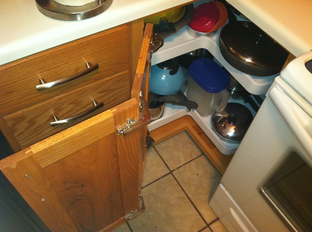

That method is correct, IF you're using a bit narrower than the actual cut you need. Let's say you needed a slot/cut, centered, 1/16" wide, but could use a bit with a kerf of 3/64". To get an end result cut of 1/16", the cut would be done in two passes, cutting from each side. This is a fairly common 'trick' used in woodworking.
I scratch built cabinet doors with this method. Needed a slot cut along the rails and stiles to hold the plywood panel. You'd think I could just make a 1/4" dado, but no, as the plywood panel was undersized and not 1/4". Therefore, I used my usual blade, cutting offset of the center, in two passes, which nailed the proper width I needed.
Here, the rail and stile joints are cut so that the tenons/slot/plywood are slightly under 1/4":
Knowing the way a router works, I wouldn't think you'd have issues centering a cut.
