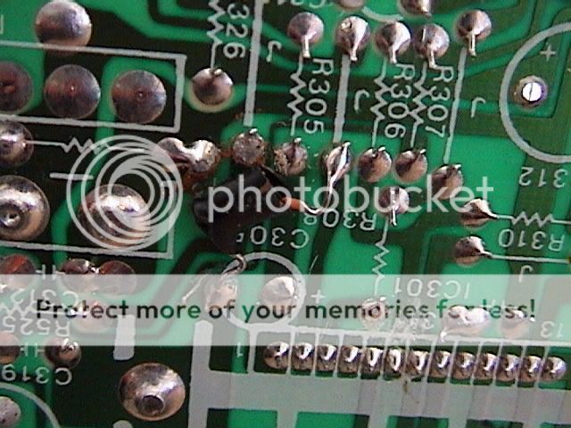

capkit didnt work what next??
Liu Kang
Apr 8, 2009
60
0
Morro Bay, California
i have a neotec Monitor that came out a Blitz 2000 Machine. the monitor stoped coming on but the yoke would still lights up, i did a cap kit and still no video. what should i address next
I had a similar issue when I did the cap kit on my WG U5000. I went back, checked all of my caps to make sure they were in the right place, they were, then I checked every solder, made sure they were good and there was no splashing. I found a couple of ones that looked crappy, fixed them, and it worked perfectly. Try using a jewelers loop or magnifying glass to really look at each joint, that helped me a lot.
i checked all the cap and they seem to be right, but i notices this when i was doing the capkit last night:
http://i698.photobucket.com/albums/vv344/Liu_Kang_MK1/DSC00595.jpg
it look like a diod or somthing not sure that is going from the negtive prog of the c305 cap to another spot a board. it was problay done bye the arcade in santa cruz, CA on the boardwalk where i bought it. i only paid $100 and it work for about 6 month before i ran into this problem but now it seem the PCB is also not working :( but i havnt lost hope on the monitor. even know the bottom of the board is wired i dont thinks thats the problem cuz before the capkit here was this some picture on the monitor now theres nothing?
i also didnt repalce the C305 cuz i didnt want to mess with it and on the neck board there was no C920 ever there so i didnt want to put one there.
