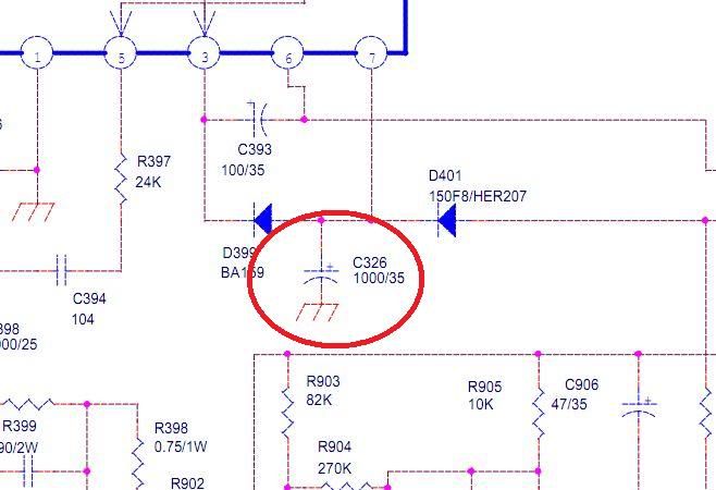

BTW, not knowing how to read schematics, where does it tell you what size each cap is?
Some schematics will come with parts listings, but if you only have a schematic:
You zoom in, scroll around until you find the cap you're trying to replace, then check the value. In the pic below, C326 is a 1000uf 35v cap...
Got it -- thanks!
It seems like not all of the caps have values associated with them -- or some of the C's aren't caps perhaps.
But I did find C970 and it indeed is called out as a 470uf 25v part.

If you are referring to something like C394 in the pic above - where it says "104" - yes, that is a capacitor, but of a different type (most likely a ceramic cap). Those caps use codes to infer their value in picofarads, with the first two numbers part of the value, and the last number showing how many zeroes to put on the end (in this case 4). That would give you a value of 100000pf, or 100nf, or 0.1uf.
Or you can just type the code into this:
http://www.electronics2000.co.uk/calc/capacitor-code-calculator.php
Wow, great info, thanks!
