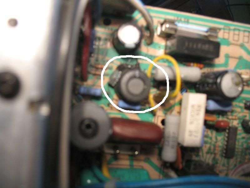

I have a monitor board where alot of the caps have oozed their inside crap on the board . I'm about to do a cap kit but wanna clean the board up . Any one got tips on cleaning the crap up ? Usually I just hose it off and let it dry off out side , but this cap ooze it pretty bad .
That "cap ooze" is probably not from inside the caps at all. This was a type of epoxy that was put against certain caps (usually the large ones) to keep them from vibrating during operation.
I usually just try scraping them off if they cover the lead holes. Otherwise I leave it alone....

cool , I didn't know if leaving it there would cause problems later . Less work is always good !

cadillacman has informed me that this is a coil on my WG K7000 board , are these easy to replace ? It too is leaking as well as the caps ,
Coils don't leak anything, they are just wire wrapped around a piece of metal.
I actually considered giving this answer, but then realized that if it DID somehow short out and overheat, the plastic coating would melt and look like it was "leaking", so I went another route...
