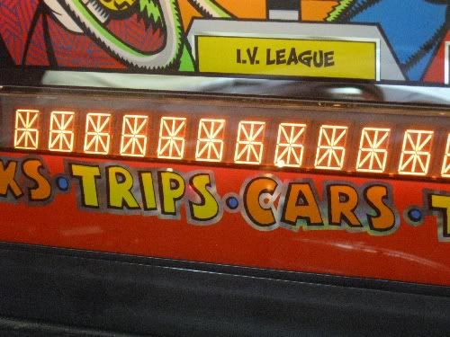

I have an annoying missing B segment on the Right Display of a Sys. 11 game. It's a Bally, and uses two 16 character displays, Left and Right. Since I bought it, the segment has been missing. All the other issues are out of the way on the game, except for this.
I tracked through the schematic, and the B segment goes through a 10k resistor, 4049 chip, 7018 chip, and an 18k resistor. All of these checked out, but just to be sure I replaced the cheap resistors and put a new 4049 chip in just in case. 7018s are harder to find and more expensive, but it checks out anyway according to my multimeter.
Pinrepair lists a capacitor/resistor network on the main board as a possible culprit, but this doesn't seem to be that kind of issue either. So, what else could it be? Could the glass be shorted?

Can you switch the displays to determine if it is the display or the electronics driving each 16 digit display?
I wish, but the left and right displays have different connections. Switching them just displays garbled text. But, I did do that just to see if the right display switched (to the other side) shows anything in the B segment, and it doesn't.
