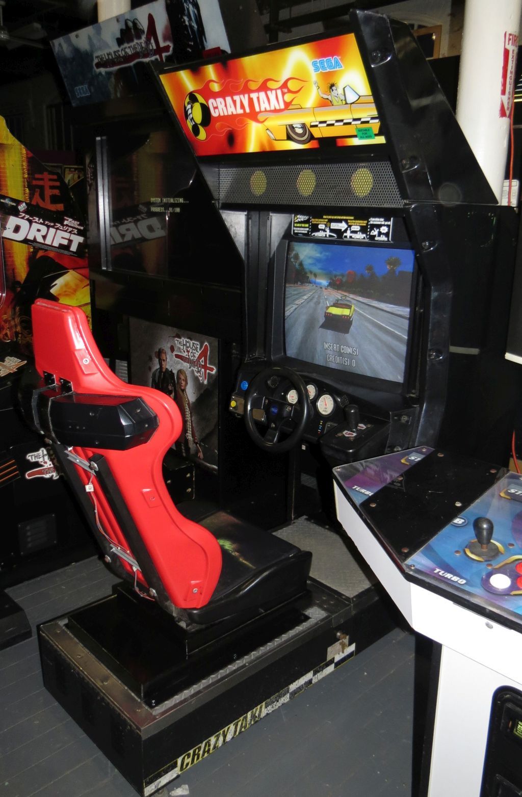

Hi guys. I'm looking at buying a sitdown Crazy Taxi Machine. My problem is I want it to put this in my basement and this is a big Machine. Is it possible to remove the base and the seat from the machine then re-connect it in the basement? I know it would be impossible to get it down there in one piece. Any suggestions?
I notice there is a lock assembly on the base. Any chance that holds it together or does that do something else? You can see keys in the lock below the seat on the base in this picture.

usually the rear section/seat separates and the manual will show you how it's done.

It looks like the same arrangement as my Xpand Rally Extreme cabs.
You unbolt the seat portion at the bottom and and the whole seat section ( from by the gas pedal back ) slides off a pair of rails.
Then you unbolt the rails from inside the bottom of the cab so it's flush for transport.

Can't tell from your pic, but mine has the coin box hanging off the right side of the cabinet. Needed to remove that to fit thru a standard entry door. Just a couple of hex bolts and molex connectors to deal with.
You can split the unit in two pieces. The base and the cab. You can take it apart even further by removing the marquee assembly and the seat assembly. The cab is heavy with the crt and steering assembly. You can take them out but it all depends on you at this point.
A dedicated Crazy Taxi does NOT break down like other driving games. it is a solid metal base that runs the length of the game.
I was able to move mine fully assembled downhill and into the basement with he aid of a furniture dolly and an extra set of hands. attache Furniture dolly to back of game and strap (tightly) under the dash up against the metal supports. Your helper can lift up under the seat to help his the whole thing back onto the dolly/wheels.
fortunately I have a set of double doors into basement but if it's a singe door then you will need to remove the coin box.
I would make sure to have at least 1 other person help me move it. How long did it take you to tear down move and rebuild?
About 1-2 hours, you start at the topper, then the take the side panels over, then the steering panel, bezel, monitor, tuck all the wires down, then take the entire top wooden box off. You can take the seat and the metal part that connects the top wooden box with the base but I just moved it together.
