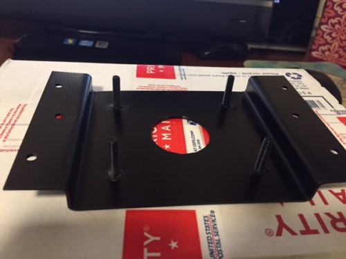

I had these made a few years ago. Same idea, but easier to build. It just requires a square hole through the wood, and a small routed li- around it to install. I had to do 30 of them to get the cost down to $10/ea.
I have 7 of them left over and will sell them for the same $10/ea that I paid.
They are for American joysticks. I have mounted over 20 different sticks to them. Most fit great, some are a little tight, but still worked. It probably would have been better to use a little smaller diameter stud to account for small differences in the joystick mounts, but these worked well enough.
Get exactly what you want if vegas12 can get them made, but s he said, quantity is the key to getting them done somewhat affordable.
