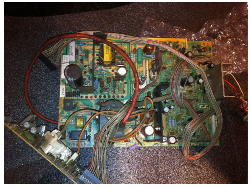

Can anyone help me identify this Wells Garnder chassis model number?
smalltownguy2
Donor 2013
Dec 30, 2008
17,076
2,650
Osceola, Wisconsin
I'm pretty sure it's a 25" chassis, but can anyone assist in identifying the model number (or at least the family) by sight alone?
Thanks in advance...
Thanks for that. Any reason why I couldn't drop that chassis on a tube that was used for a 25K7101?
The tube # is A63AGD01X, which indexes on the B&K setup charts as a CR-23 (10 pin), and 6.3v heater.
I believe this should be compatible, yes?
yeah, the yokes are totally different, more than likely to accommodate the higher medium resolution.
if I'm not mistaken, you can run a low res U2000/K7400 with a U5000 yoke, but not the medium resolution K7500, at that point you have to replace the yoke.
and forget about interchangeability between a K7000 and a U5000 (or really any other chassis made by WG lol)
If you look at the small tag on the LH side of the chassis at the top, the chassis model is identified in the first line just after the WG. Just posting this for future posterity.
I believe Pat is referring to the "WGM25xxxxxx" label.
I have a tendency to just refer to the "P738" type numbers.
(been meaning to make a list one of these days)
But always nice having multiple ways of identifying WG monitors.
