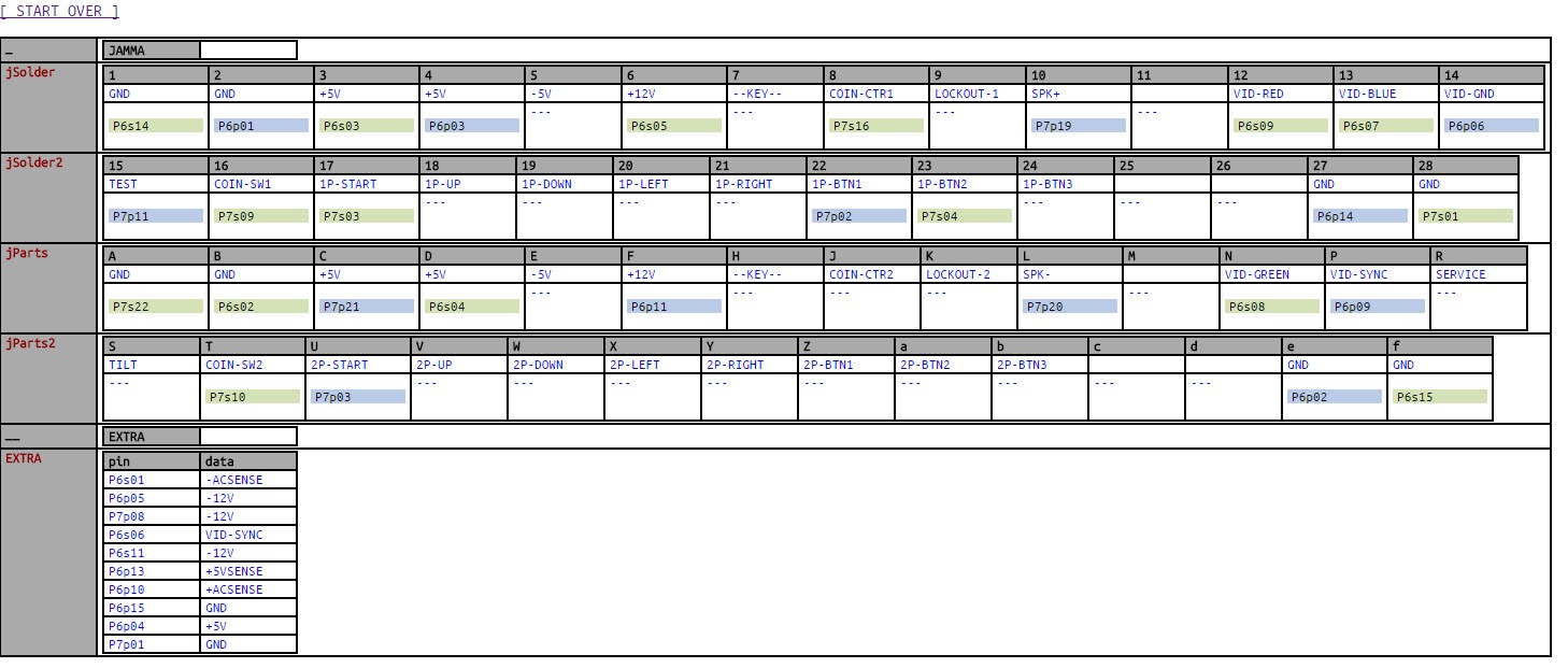

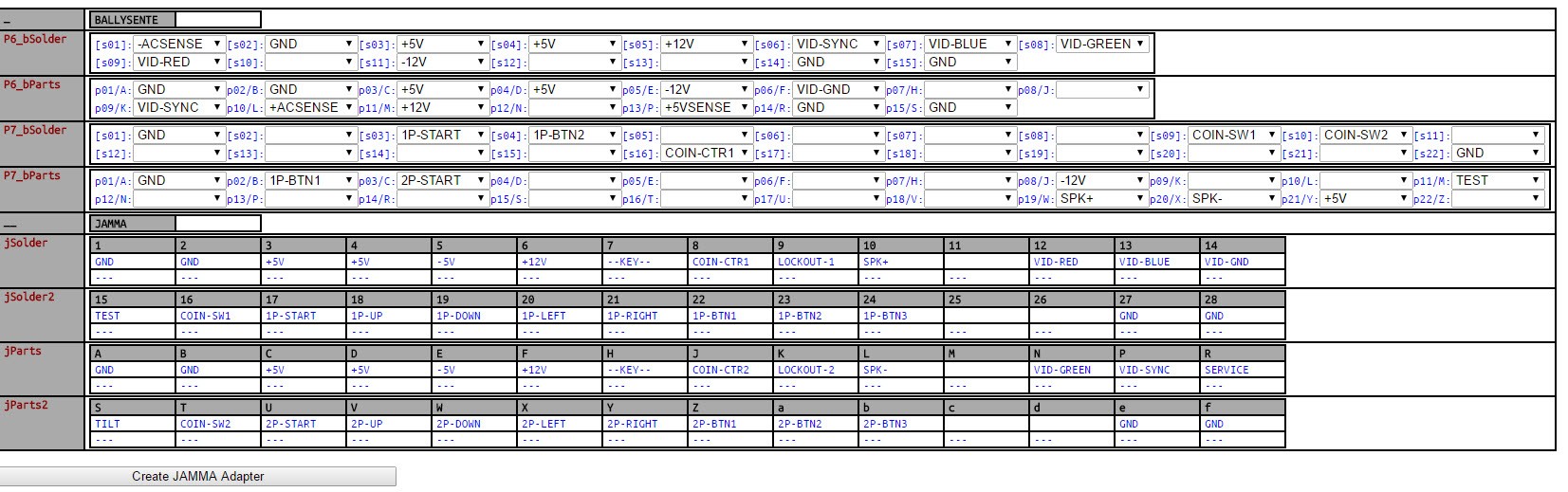

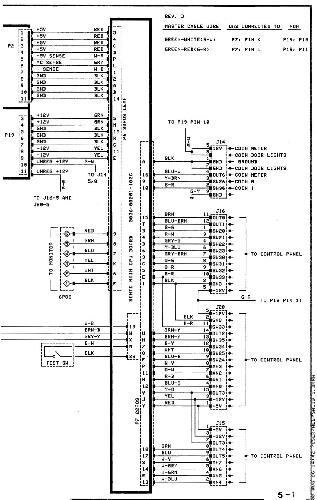

But I got to some crazy coding that you plug in all the pins on bally/sente pcb and the code prints out what pins they connect to on a JAMMA harness to make the adapter work a little bit easier...
Starting with the last page pg 5-1 (physical) or pg 67 (PDF) in the Bally/Sente SAC-1B schematics manual (0E19-00300-0000):
This is how the input screen looks like and what I entered in for each pin:
And this is the output screen mapping the bally/sente pcb to the JAMMA pins:
So yeah, still a major PITA and a work-in-progress...
What do you guys think?
