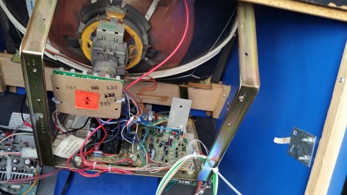

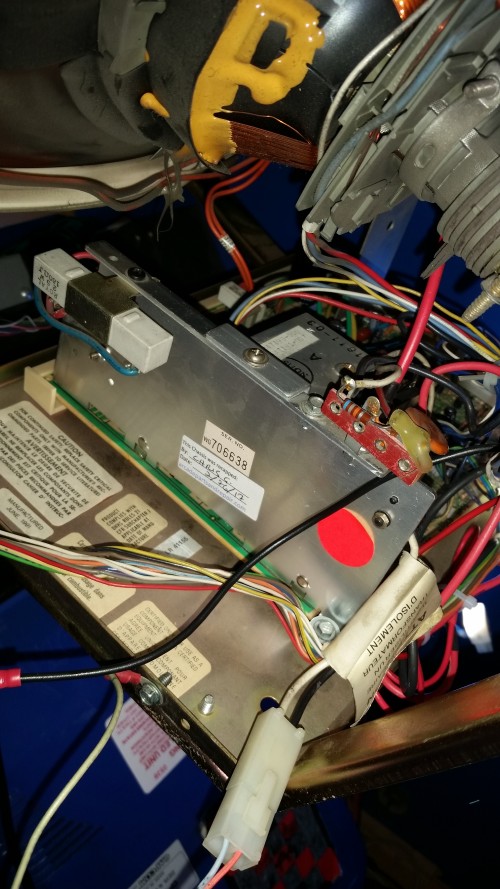

pictures of chassis.
medium res K7000s had a small board mounted above the flyback with a red wire that goes into the deflection board and a white wire that runs to one of the neck socket pins that's lifted out of the neckboard.

K7191 - chassis that will be getting monitor, if it works:
K7193 - chassis from which monitor is being taken to pair with K7191, if it works:

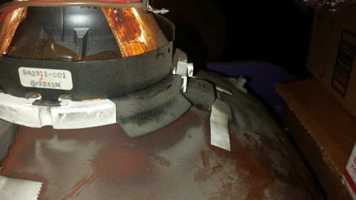

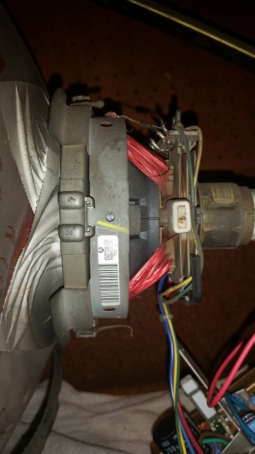

Here are pics of the yokes. Not sure if these are the numbers that are wanted. If not, let me know where I should be looking.
One thing that caught my attention - the K7191 tube has not convergence strips or yoke wedges.
K7193:
K7191:
Thats an odd looking yoke, that second one. Maybe someone subbed a tube at onee point. K7000's seem to run on a variety of tubes. I can tel, you that we don't differentiate between 7191, 7193, etc on the route. 25K7000 is how we list it amd have never had issues.as for the yoke impedance.. well someone else will have to comment on that I have stuck 7000's on a couple odd tubes and had no major problems.
Wells Gardner K7000 WGR2570-U1GS30K 054A7193-001 025A1341-001 009A2911-001 088X0407-506 25" CGA 15.7KHZ k7000 UNIV FRAME REFURB
From http://arcadecup.com/
009A2911-001 == 9A2911-001
Not sure about the 7191 yoke. Maybe someone did a tube swap?

that looks like a Polo yoke because of its boxy base. I can't tell because the picture's zoomed in on the numbers, but it looks like there's no rings. Polos didn't have rings, they had some magic box that did the convergence. and the Polos have 4 pins that stick directly out the top, some variations had the yoke wires connected to them with plugs. someone at least had the decency to replace the yoke plug with the correct one if that's the case.
that'll explain why the ohms are different.
