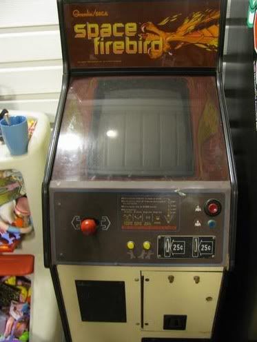

Did you notice that it says Fortek on SRW's board set? Weird since it is in a Nintendo cabaret cabinet...
attachment.php
Not weird at all. Space Demon only came in that cabaret, never in any other cabaret.
Space Firebird, though licensed from Nintendo to Sega/Gremlin, was never housed in Nintendo Cabaret. Instead, it was in its own cabaret:
