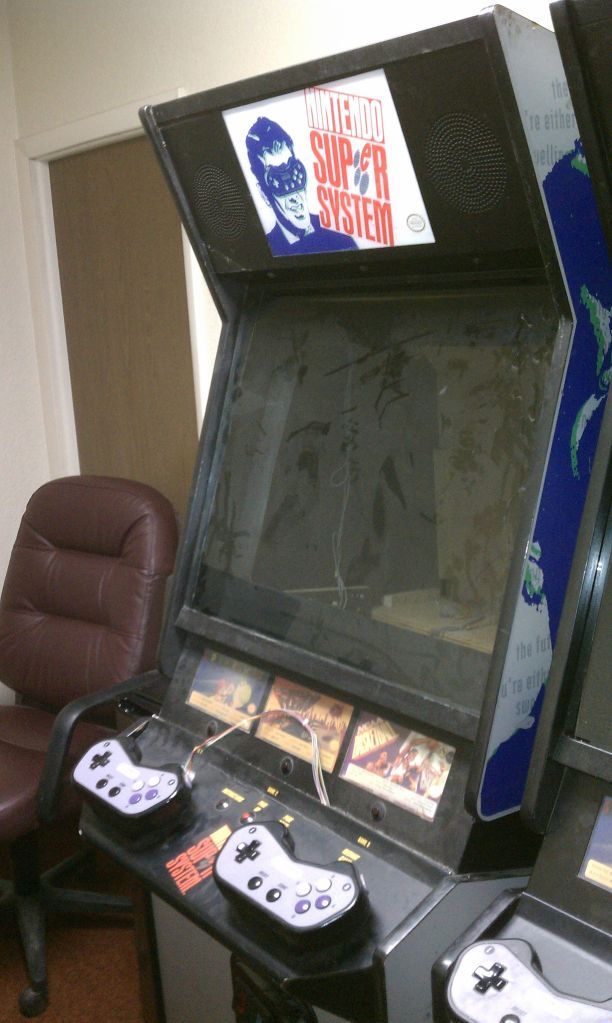

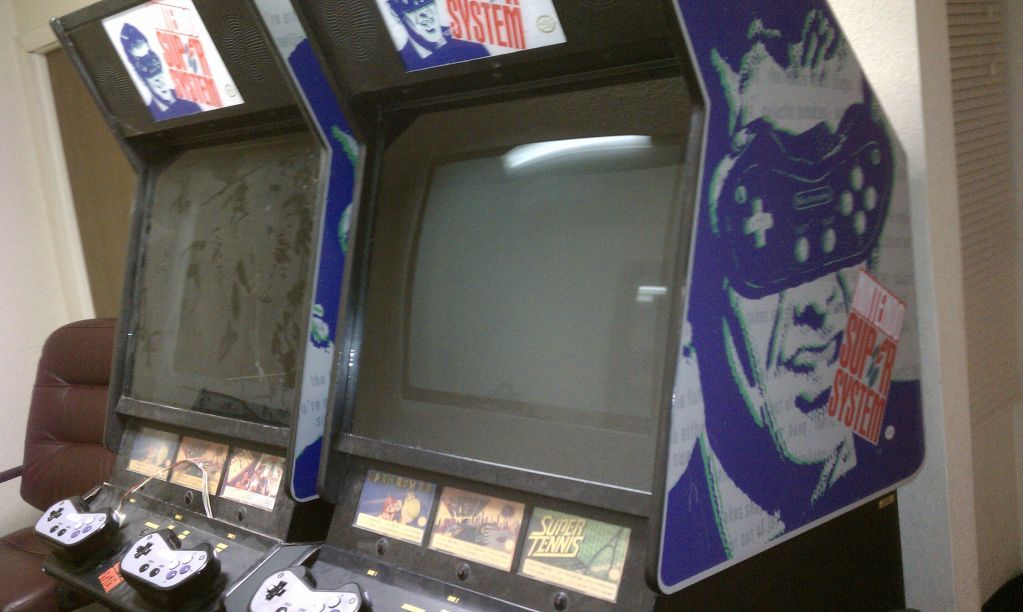

The 2 Nintendo Super Systems need repair and a monitor

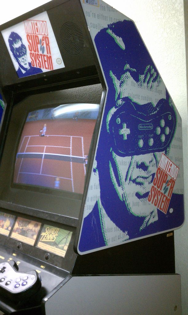

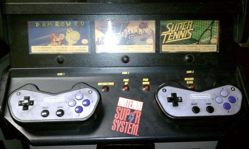

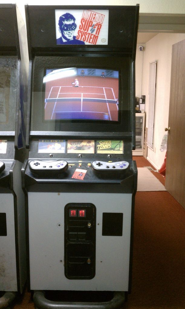

I got some work done on the Nintendo Super Systems. It seems that one was missing a monitor, but otherwise was in good shape. The other had a blown power supply, a missing game rom (super mario world) and another game rom that isn't recoginized (NCAA Basketball). I merged the two and ended up with one really nice one. It's so nice, in fact, that I'm going to buy light tubes and starters for it. It's too bad I gaussed the screen up when I was mounting the speakers. I'm assuming it will degauss itself after I fire it up cold a couple of times.
The other one? It has a good PCB and it's sort of complete, but the cabinet is pretty beat up and I'm missing a 25" monitor so I'm trying to decide what to do with it. I'm considering stripping it because I'm not going to sink any money into it and I don't think anyone around here will want it the way it is. I have a f-zero rom, but those seem to be a dime a dozen.
