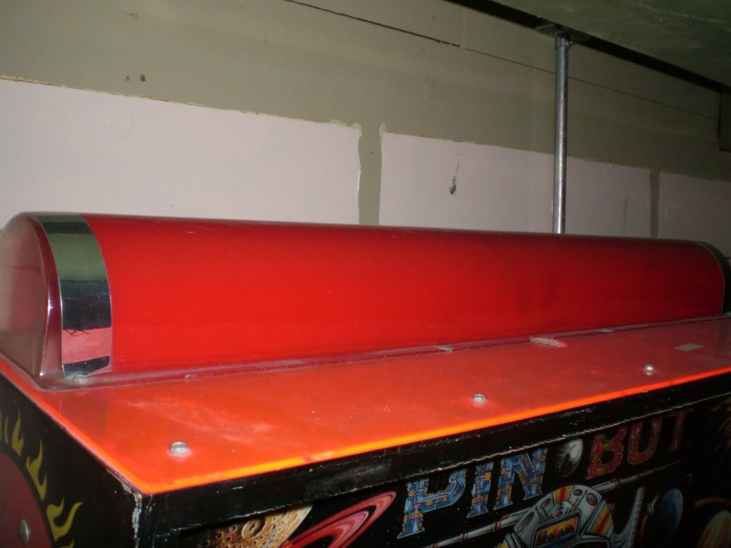

Okay, I'm not going to keep looking for one of these..I'd rather try and fabricate my own..not quite sure how that will work out, but I've got to start SOMEWHERE...
I need pictures, measurements, etc of the topper, specifically the tube portion, and brackets/mounting hardware would be great. Help a guy out here...this thing seems to be a real PITA to find a replacement for, and it appears to be such a simple thing.. should be able to figure out a way to make one..
I was actully thinking about your missing topper and wondering how to manufacture one. I think that as long as you get the right curvature you can use a piece of bent sheet metal or flashing, place a sheet of lexan or plexi over it and slowly heat it with a heat gun until it conforms to the same curvature, let it cool then paint. It wouldn't be as nice as the original but it would look better than not having one.
That reminds me of the fabrication shown in some video. maybe it's the shaggy pinball repair videos? putting ?lexan? sheets in the oven and letting it bend itself around the mold.
Vaccum forming in home environment pretty much works that way. I figured id use a heat gun, just a matter of what size it is and how it mounts.

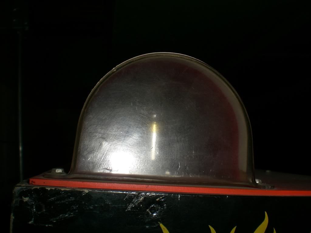

Attached are a few pics of my topper. It's 4 inches front to back, and 2 and 7/8 inches high.
Oh sweet. Thanks. Thats interesting. I thought it would be thick like the base but looks like its thin an painted inside?
