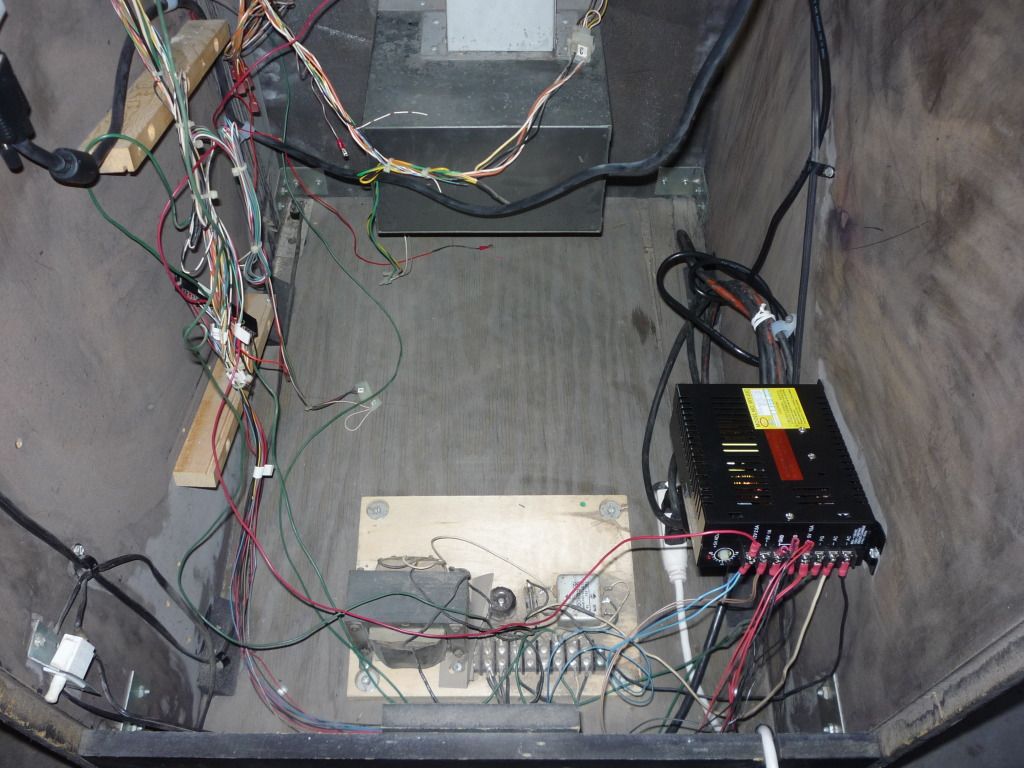

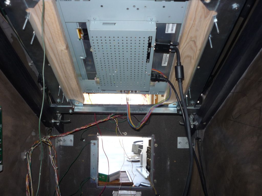

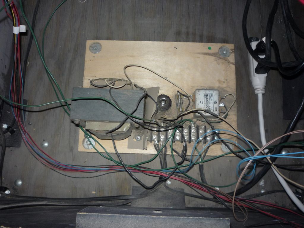

I posted this last night and it looks like it's gone. So here goes again. I put in this new lcd monitor and had the game working. Then it just died. I replaced a fuse and the power supply. What to do? Thanks in advance for whatever advice you have!
Check the white push button on the backdoor area. If it's not compressed enough (which happens at times) the game will not turn on.
Oh my God. I feel so stupid. I forgot that it was taped down. Ultimate DUH moment broadcast over the Internet. Thanks a lot. Problem resolved!
Not a problem, glad it's fixed. It's always the most obvious fixes that seem to get overlooked.
From the pictures it looks like it's too far set back in the cab? Maybe move it forward so the backdoor holds the button down?
