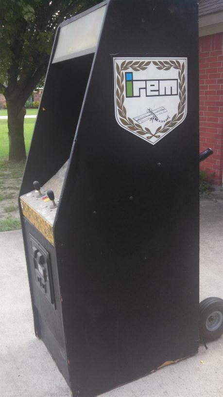

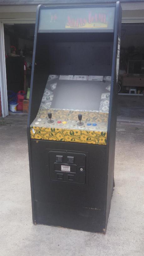

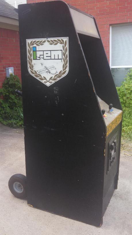

Can anyone tell me what this cab was from?
It looks like a Space Ace or Thayer's Quest, but with the wrong marquee shape...
It had what looked like 4 rubber shock mounts in the bottom of the cab, but I don't have a pic of the inside.
attachment.php
Looks like this Space Ace cabinet on KLOV. It looks like a Dragon's Lair, but different than the Dragon's Lair flyer. Not sure if the flyer was just a prototype or why it is different, but the angles, CP, etc look right. The marquees often got replaced when they stuck a kit in so that they could use the kit marque.
Oh, I can see the speakers in the right location on that thing too. Certainly looks like a Cinematronics cabinet with the marquee cut off. So I say converted Dragon's Lair.
I would agree cut marquee cinematronics cab. look at the back for laser disk drawer and if the DL/SA score board covered over above the marquee.

That's almost certainly a converted Dragon's Lair. Keep in mind the Space Aces in this cabinet were field conversations as the dedicated Space Ace cabinets have a different shape, including the marquee area. The other things suggested in this thread are also good ways of identifying the cabinet. Further, it may still have the factory DL sticker on the back showing the model #, which starts with DL, and serial #.
The marquee being cut flat was typical for DL conversions (my buddy has two cabinets like that).

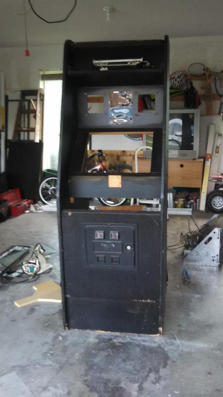

The Serial # plate had been painted over, but a bit of alcohol and a little elbo grease cleaned it right off... LD 07922
So this was originally a Dragon's Lair running on an LD-V1000.
However, the control panel had holes for the Space Ace skill selection, so it got converted, at least twice.
The three sided marquee got cut off, but the biggest issue is the front of the cabinet. The wood holding the coin door was completely broken, and covered over with a plywood bandage. Time to buy a table saw.
