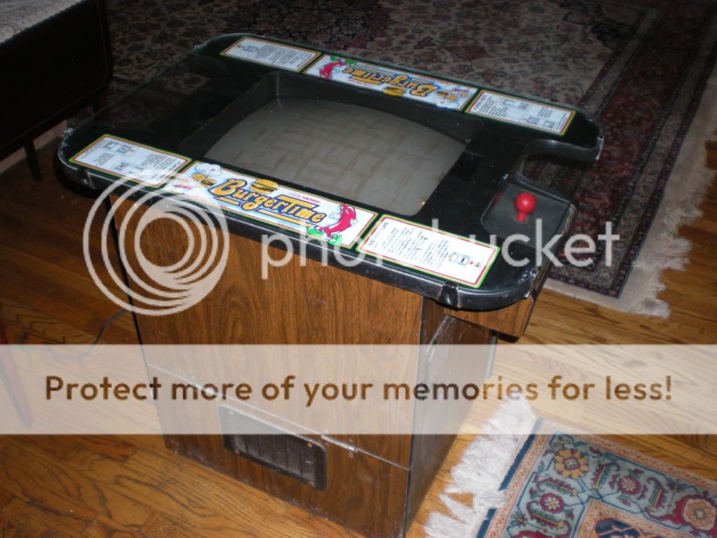

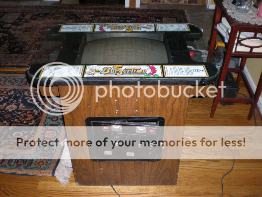

Hello All,
I am new to the board, and new to arcade game ownership. I just picked up a Burgertime cocktail from a neighbor. He said it used to work, but he had to move it and after that he said it no longer worked. I have a buddy who used this board to help him with his Ms. Pac Man.
So here is the deal, the monitor doesn't work. I can hear it power on, but nothing shows up on the screen. I can see the tube has a slight glow, which is a good sign. I have looked around for loose wire and found a ground strap that broke (which goes to the coin door), and another random green wire with yellow stripe that looks to be a ground. Also someone changed the power cord at one time and used butt connectors and on of the wires worked its way loose. I square all these issues away and no go. The fan(s) are running, and so are the lights for the joystick.
Any ideas? I am a bit fearful of pulling the boards because i really don't know much about electronics. I did pull the connectors for one of the board and looked at the brass connections, but they looked fine. I tried toggling the test switches, and nothing happened.
Any help would be appreciated, or if anyone is local and willing to help, I would deeply appreciate it.

If you can hear the game playing and the tube has neck glow your monitor is most likely in HV shutdown. It'll "probably have a G07 in it" and Dokert is pretty handy with those.

Does the game play? Can you hit the coin switches, and hear the game starting? If not, you may have power supply/ board problem.

I don't have any sound, not even if I load credits. I am also not getting any lights on the coin door.

I checked all the fuses that I could see and they all look fine. As for the power supply, I will check the voltage, but like I said, the green wire running into the power supply was disconnected when I first got it, I reattached this wire, but there was no change. Could this have done some damage when it was not attached? I did start the machine with this wire was unattached.
Bt ct
That is cool. I have not seen the CT version in a long time. I would reseat all the connectors including the ribbon cables on the board and power supply for a chance something came loose in the move. Good luck and welcome to the forums.
