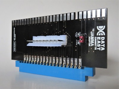

  • BT-to-JAMMA adapter
  • Then use a JAMMA switcher
  • Then use a JAMMA-to-BT adapter for the original BT board
  • And use the JAMMA switcher to connect SBT (which is already JAMMA)
and that allows both boards to run on a switcher in the BT cab without hacking the original harness.
So, two adapters and the switcher
