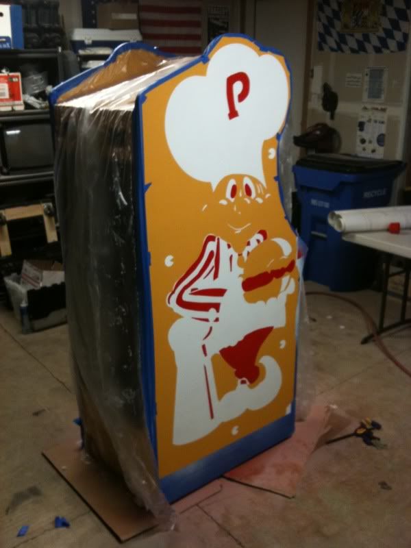

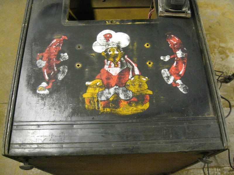

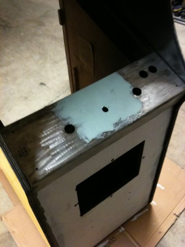

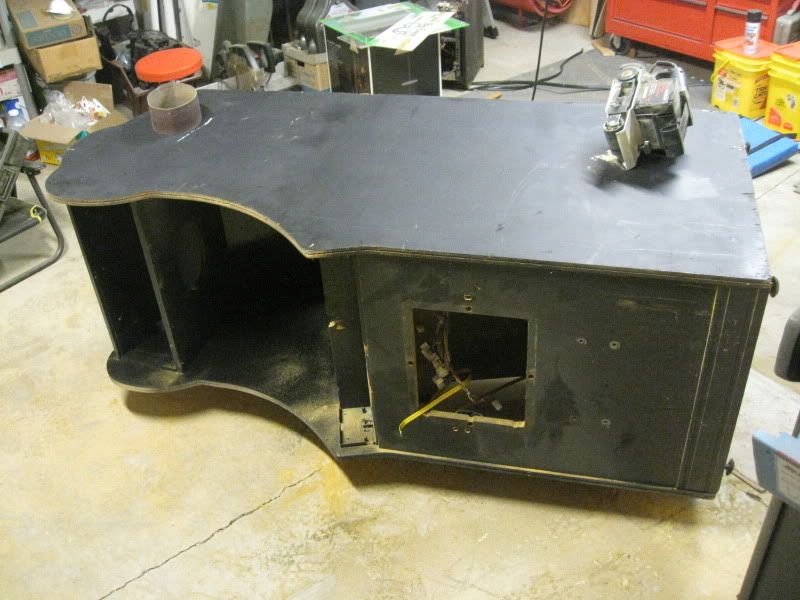

So I picked up a horrible conversion to Big Event Golf from the infamous Burgertime. It was my first game, and wasn't sure what to do with it until I researched just how cool a restored Burgertime really was. Looking through other restorations online and here, I decided to start collecting parts and art for the restoration.
Here is a shot of the cab just before sanding.

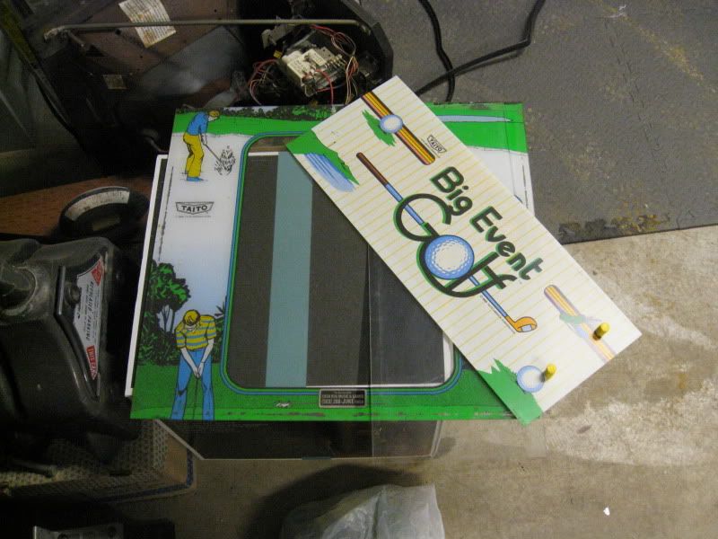

Some Parts from the horrible conversion

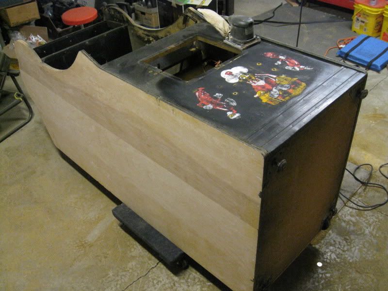

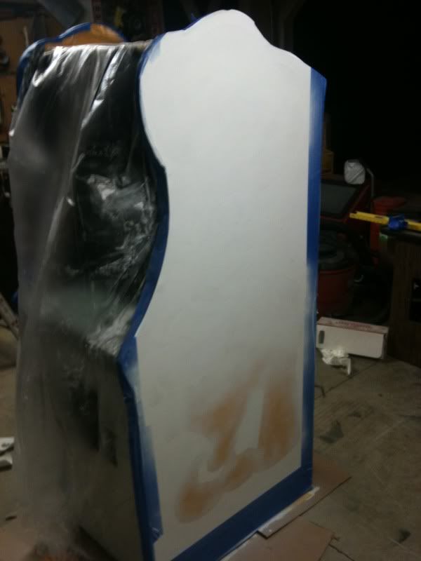

Sanding started
Revealing the magic underneath
Further sanding

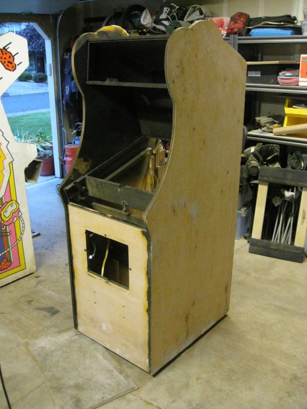

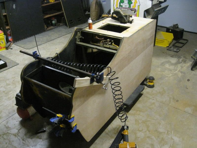

The start of cabinet repair, such as loose bracket / fasteners.

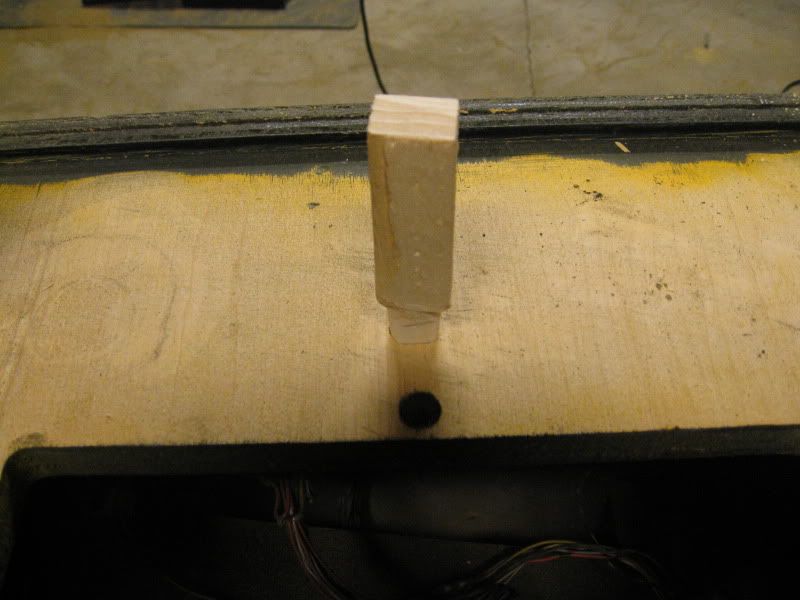

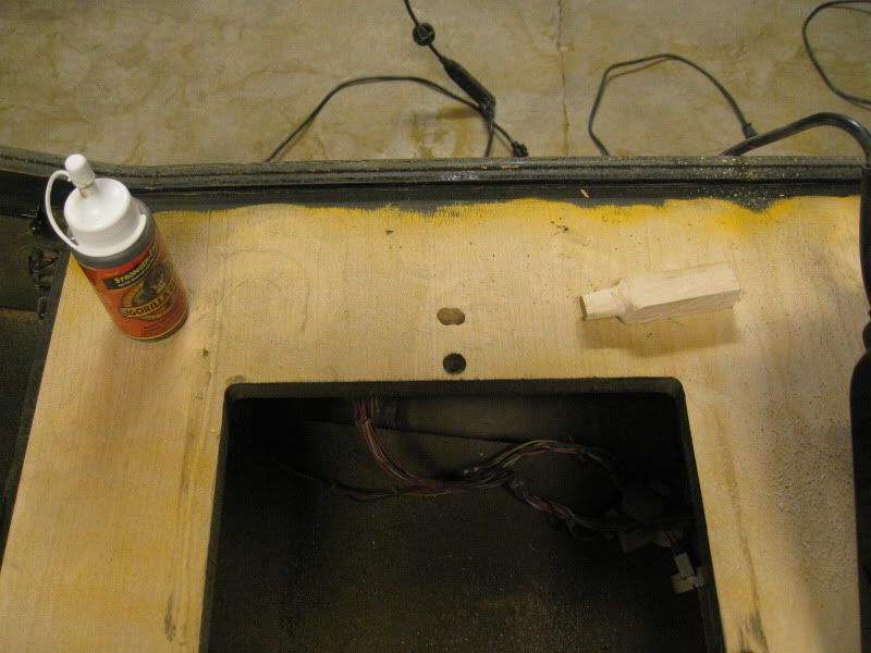

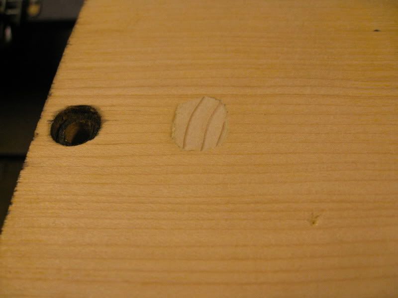

Filling in the old coin door lock bar holes.

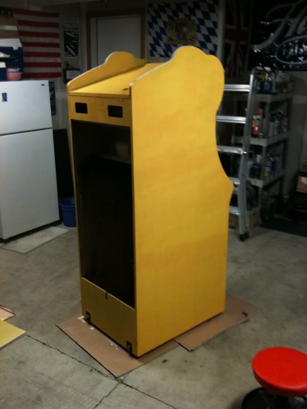

Sanding Finished

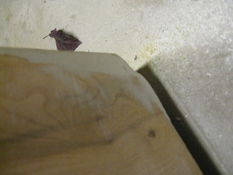

Typical bondo repair on basically all edges.
Restoration of the control panel was necessary to bring the center back to house a joystick instead of a roller ball.

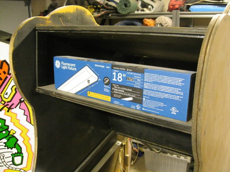

Needed a new florescent light.

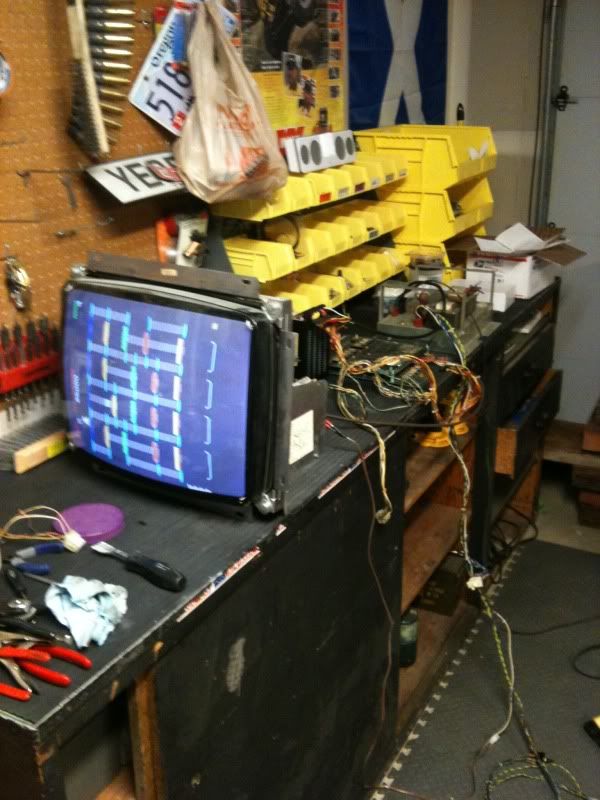

Bench testing the guts
Components installed and running well

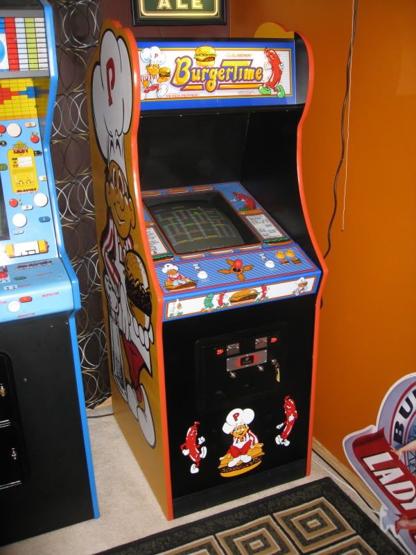

And finally, a pretty much brand new Burgertime!!
Thanks to all that helped throughout the process on recent board issues etc.
Outstanding! Simply OUTSTANDING! Seeing threads like this inspire me to do better with my current restoration and for future restorations as well!
That is a perfect example of how it's done. Great work sir, admirable to say the least.

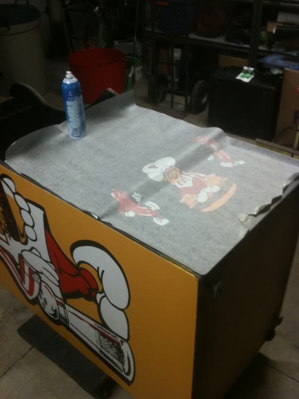

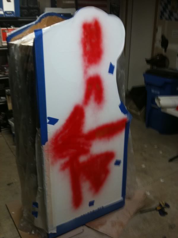

It looks like you whipped those stencils out in no time. Beautiful!!!
Hey thanks for all the great comments guys! It was a pretty long process. I had to put it down and pick it up a lot because of other projects that took precedence. I'm glad it's finally done though!

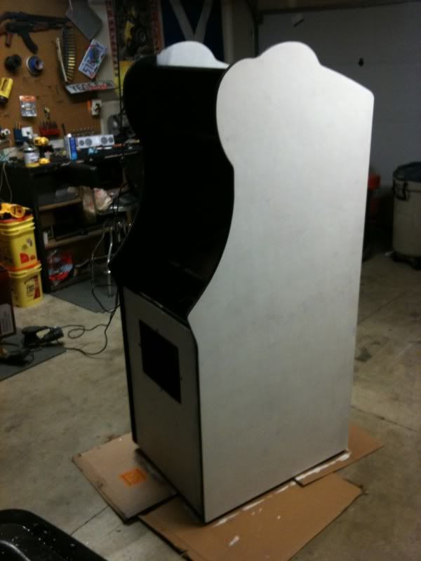

I really have no idea. I can say it is a long process to do it right. The sanding and bondo took a week or so of sanding and reapplying bondo. Party that was my fault in learning to goop it and wait rather than skim it a hundred times. The primer took 2 coats, yellow was like 5. Each coat takes an hour to apply by roller. I had time in fixing the monitor which had a faulty HOT I diagnosed. Time in stencils is really high too. Probably one evening per stencil on average. Touch up wasn't bad. the rest came together in about 2 weeks or so. So really the time is in the cab prep and paint. I've had the unit since Aug. 09, but work was very sparatic.
Awesome work. Makes me wish mine was converted rather than in nice original shape. I love bringing them back from the dead, but I hate tearing apart decent looking original cabs just to redo what's already there. That adapter is great, wish I had one of those. Mine's still running on the original power supply. Again, Awesome work. If you can restore one of these cabs, you can pretty much restore anything.
