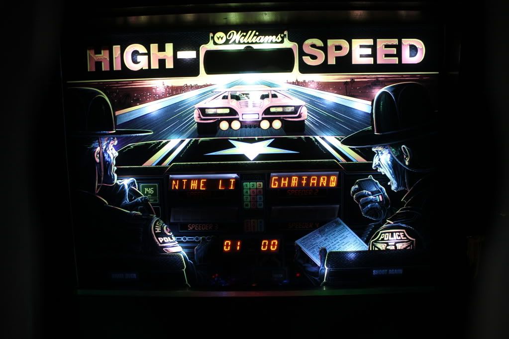

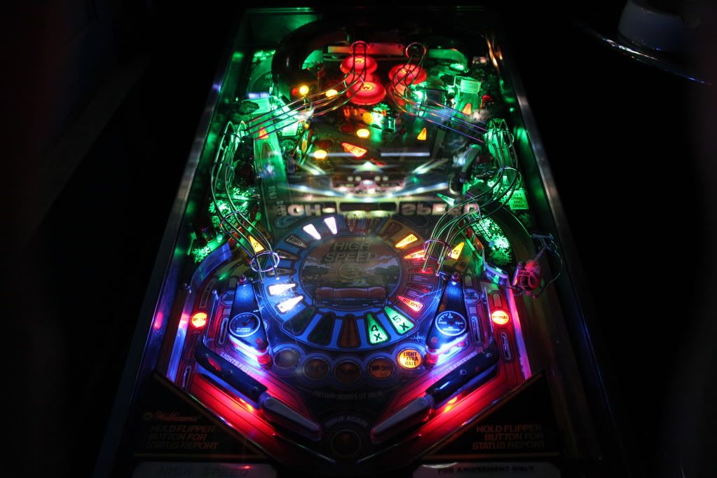

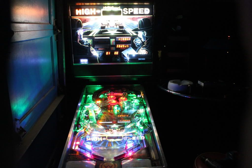

Here's some pictures of my High Speed pinball and I used Cointakers led's that I just purchased from Cax this last weekend, I think it looks great and brings an old pinball to life with the colors. I'm still playing with some of the led's placements as some area's are too much as you see with the green's but overall great investment!

IF you're going to do it, spend some time experimenting to find what looks good. I would NEVER do a 100% LED pin as much of the time it ends up looking like ass...
