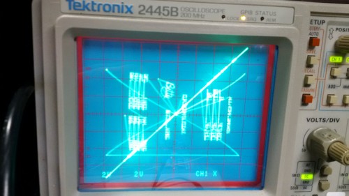

If you have an analog oscilloscope and +5V/+12V/-12V power supply, then just power it up on the bench like the Big Boyz do. :)
Seeing is believing. Then worry about playing later. (Remember that +12V needs to be applied to the 10.3Vunreg pin for the POR).

Just remember, if powering up for the first time in a cabinet (or on a bench) with a 6100 or AMP, disconnect the monitor and preferably validate it's playing/coining-up/etc and displays on a scope instead.

I picked up a space duel harness and repinned it for quantum. I still need to sort out the sound and control panel/coin door harnesses but I am finally able to test the pcb. It looks like it works! The x-axis is flipped for some reason but otherwise it looks to be working. Once I sort out the rest of the harness I'll get it plugged into a 6100.
