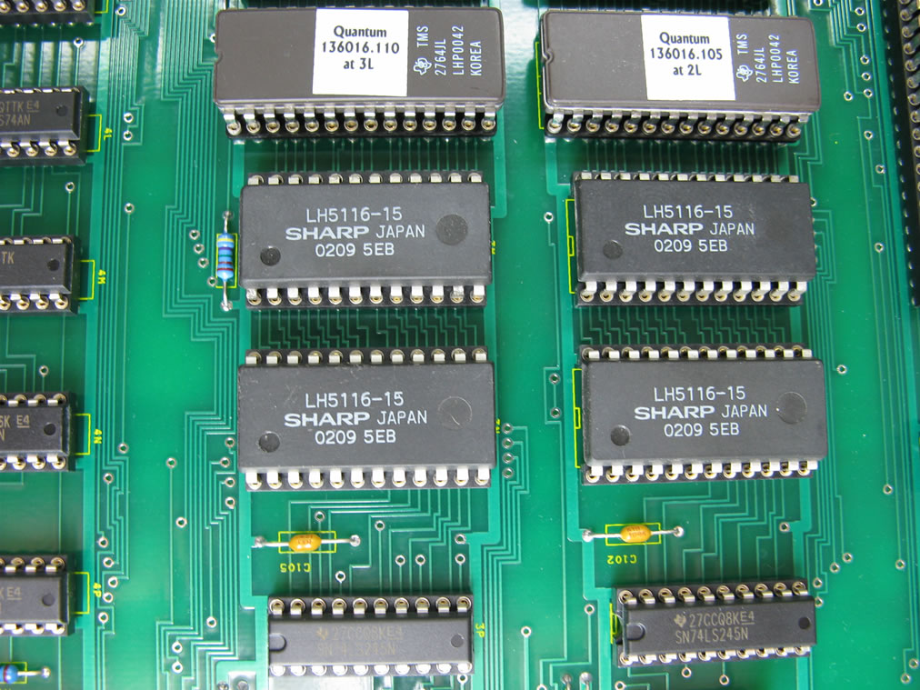

For the ram... just wanted to confirm these toshiba 2016's and signetics? 2128's will suffice.
Synertek SY2128-3 have 150nsec access times. The TMM2016P (no -x) have same rating. Should work.
There are a couple of Q threads here on KLOV discussing compatible RAM for these boards - even if they have a faster/slower speed rating.
When you power up the board, any timing issues will be obvious.
Quote from Bill BITD:
"Note that although some photos included in this package shown UM6116-2 static ram chips installed, they did not work reliably.
They often failed the powerup test. They were replaced by SRM2016C12 and LH5116-15 chips which worked fine."
