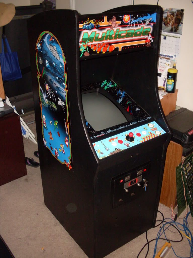

I am thinking about multicading my used & abused Pac Man Plus. Has anybody ever used all arcadeshop parts (like marquee, control panel, side art, etc)? If so, how did it turn out? Do they come out nice?
I made a multi williams using arcade shop parts and it came out very good. I recommend buying their top power supply if you are going to use their jamma harness the harness has plastic molex connectors on it that plug right into the power supply. If you use a cheaper power supply you will have to cut the connectors and wire it directly. I also bought the control panel wiring that had molex connectors which is nice for disconnecting the control panel from the cabinet. If you do those 2 things it plug and play, I had mine up and working in one evening.

This was a gutted and ragged out Ms. Pac before the Arcadeshop treatment...
