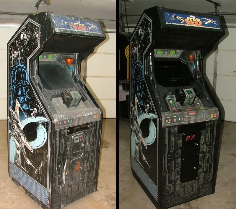

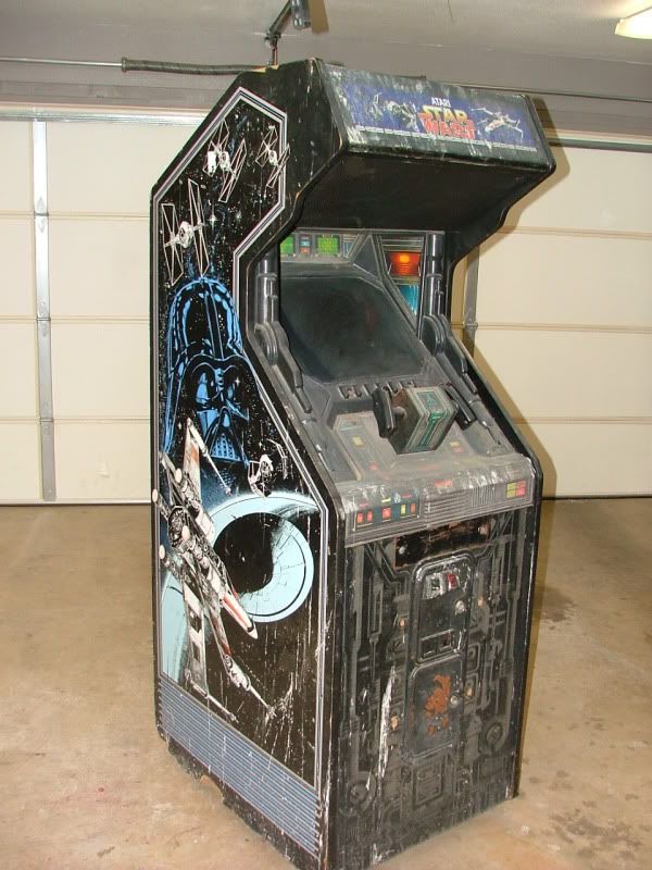

Most of you guys probably missed the thread where I picked up a beat Star Wars cab for $40, but if you want to read about that adventure, here it is. Here's a couple of pics before and after I cleaned it:

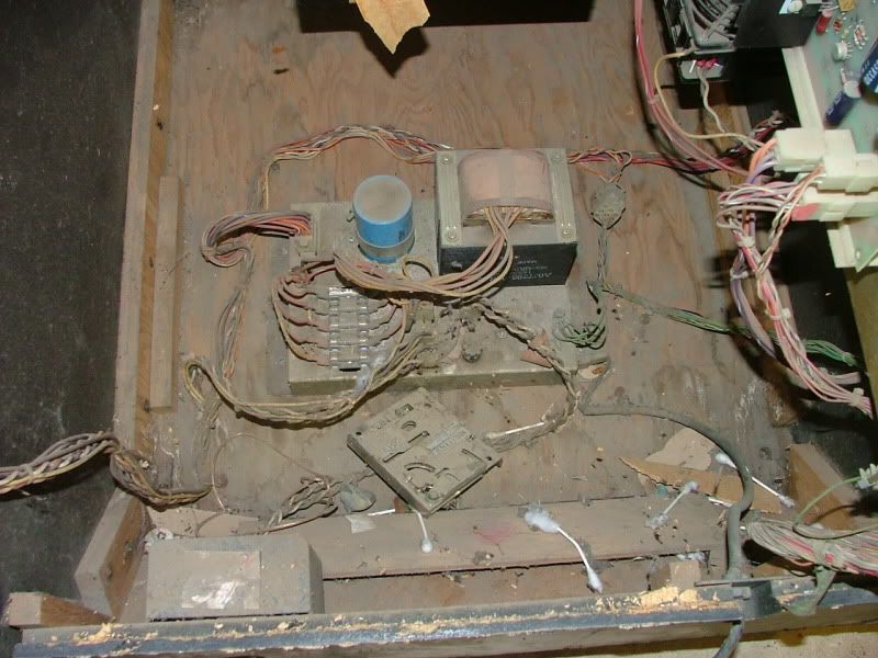

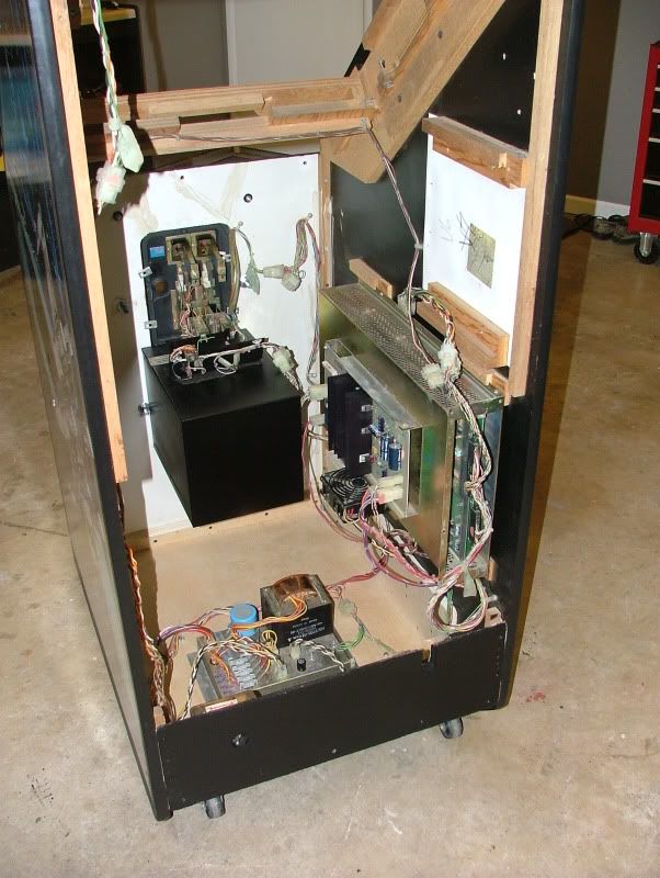

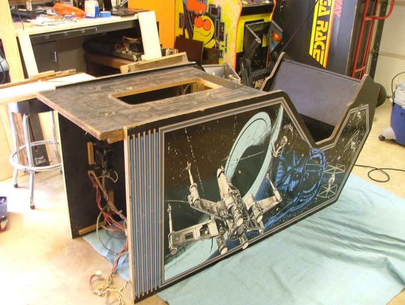

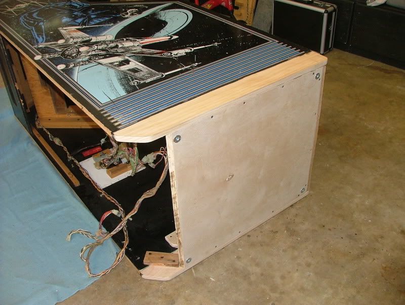

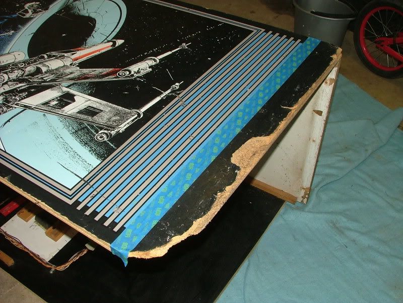

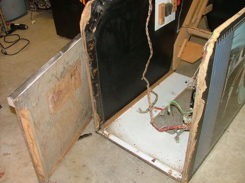

My original intentions were to totally restore the game with new art and the whole nine yards. However, my son and I were having so much fun playing the game that I just didn't want it torn apart for months while I restored it. But, the bottom of the cab definitely needed some attention. There was some water damage, and the leg leveler t-nuts were basically a pile of iron dust. I decided to cut the bottom 3" of the cab off and replace the rotting, chewed up partical board. I thought that if I was careful enough I could blend the repair into the sideart since there are horizontal blue/gray lines on the bottom of the sides.

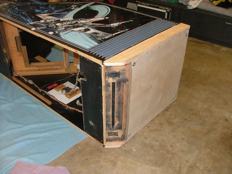

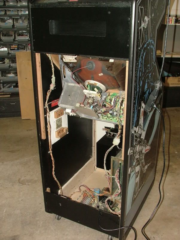

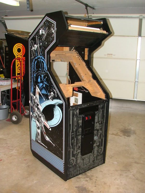

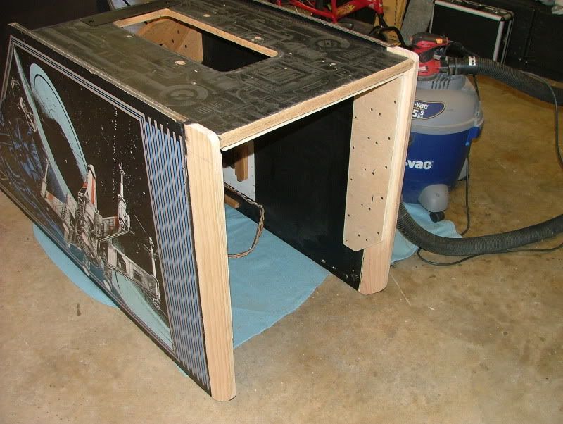

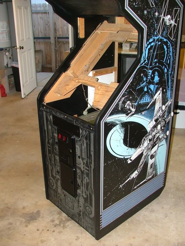

I decided to not cut the front, just because there was no way I could keep the art intact if I did. The whole front panel should be replaced anyway, it's cracked in half at the top. That's why someone put the metal plate in above the coin door. But, I was determined to make this a "budget" restore, so I kept the front panel, cracks, lockbar holes and all...
I built a new bottom from 3/4" ply and reused the back panel and the panel with the wheels. I went through a whole tube of Liquid Nails on this, so it should be plenty strong!
Now that I had the cab solid, it was time for paint and touch ups. I sanded the edges of the cab where some of the vinyl had peeled, and carefully painted the new lower sections and the entire perimeter of the cab. I didn't bother with filling in the joint on the lower sides as I was afraid of damaging the side art anymore than it already was. If I eventually do a full restore, I'll fill in the joint of course.

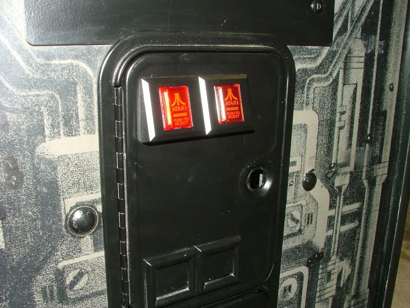

I trashed the original coin door, as it was beat beyond saving. Luckily, I had enough spare parts to build a replacement. New t-molding and some carriage bolts in the lock bar holes, and now it's starting to look pretty decent.

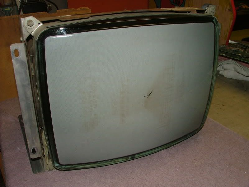

So, that's where I'm at right now. Hopefully I'll be destroying the Death Star by Sunday. I just need to finish up the monitor (lv2000 install, cap kit) and put the yoke and cp back together. I had to replace 3 of the micro switches in the yoke, so now I'll have full fire power, lol. One benefit of doing this on a "budget" is that I ordered an ESB kit from Vector Labs with the money I have saved. I should have that soon. Back to work...

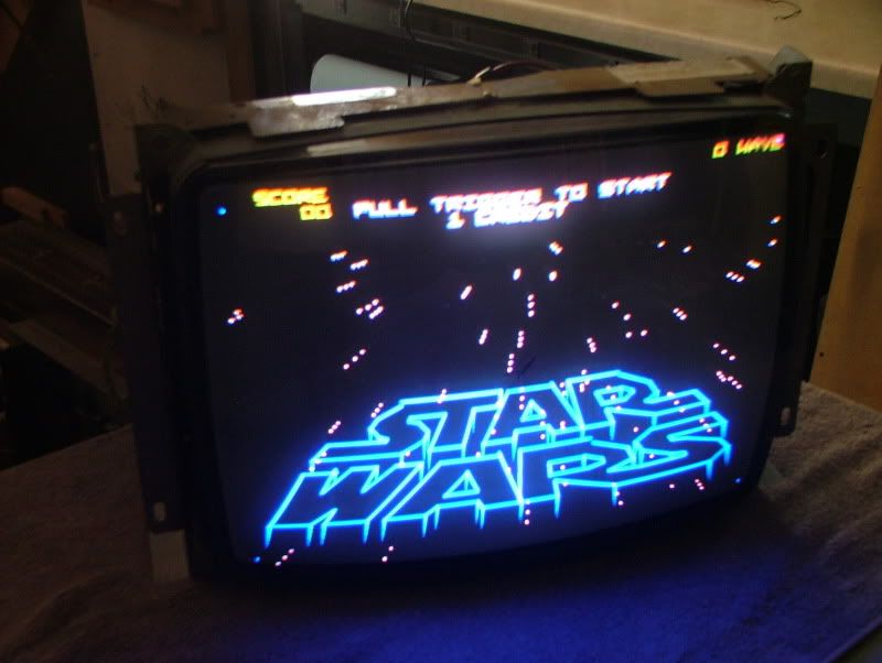

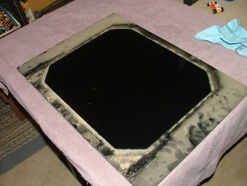

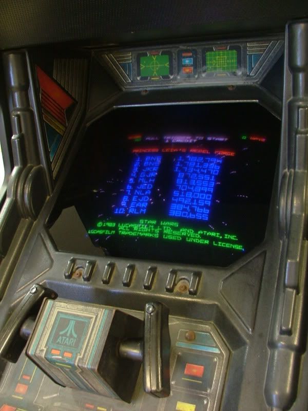

I finished the monitor work and decided to test it BEFORE I put it back in the cab... hmm, I wonder what game this 6100 originally came in?
Well, it powered up fine, and at first I thought it was okay, but then I realized that it had no green color... It took me a little bit to track that down to a solder bridge on a couple of pins on the neckboard that I re-flowed. All good now. I installed the monitor and turned my attention to the last few pieces.

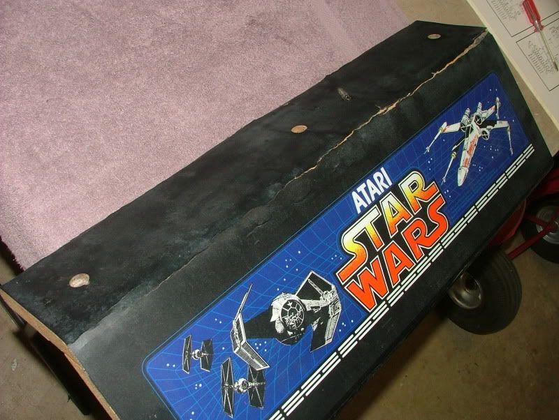

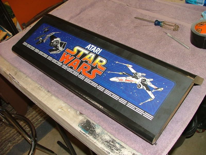

The worst is the marquee - severely cracked on the bends, but decent in the middle.
I thought about getting a repro from Arcadeshop, but that goes against my whole "budget" theme, and I've read that the quality is lacking as well. So I think I will use a straight edge to cut out the cracked area, then cover the bare spots with black tape. Kinda ghetto, I know, but I think it should look okay. Some more cleaning, and I should have some finished pics up tonight (for the 5 people who actually look at this section ;)).

My tape job on the marquee came out okay. Much better than it was, anyway...

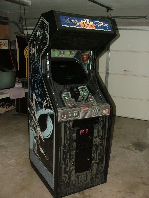

And here she is, all done except the back door:

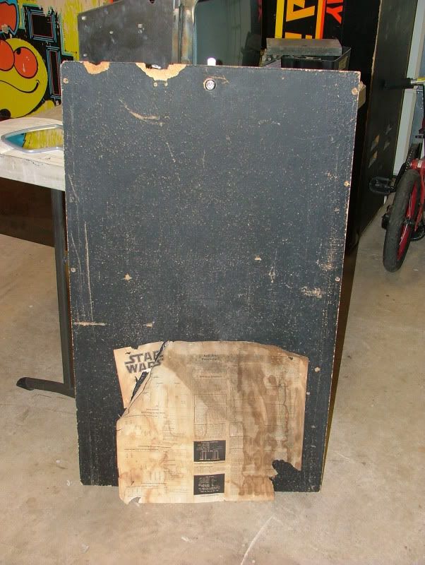

Here's the back door, and the back door sheet. I may just make a new back door instead of fixing this one. The back door sheet is beyond my help, though...
And here's a final before/after shot:
Hopefully I'll have my ESB kit this week, but till then plain old Star Wars will have to do. :)
