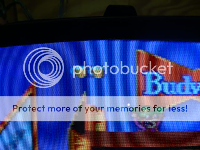

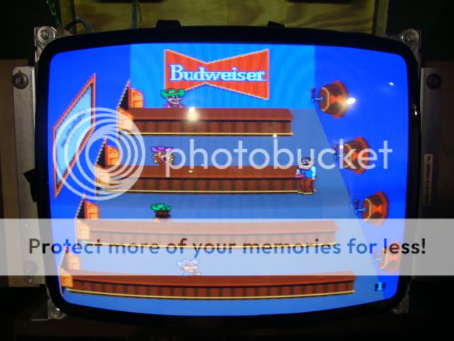

I am having an issue with the players score not showing up on the screen. Everything else seems to work fine and when the game is over it shows the score when it saves as high score. Seems to not to be saving scores though. Anyone?

The monitor is fine. Just no score.

heres a few pics
yup...I figure a cold joint....going to check them all today.
Well I reflowed and reseated and still nothing....could it be a dip switch? It looks like they only use a few on each bank....Ill try and report back....
