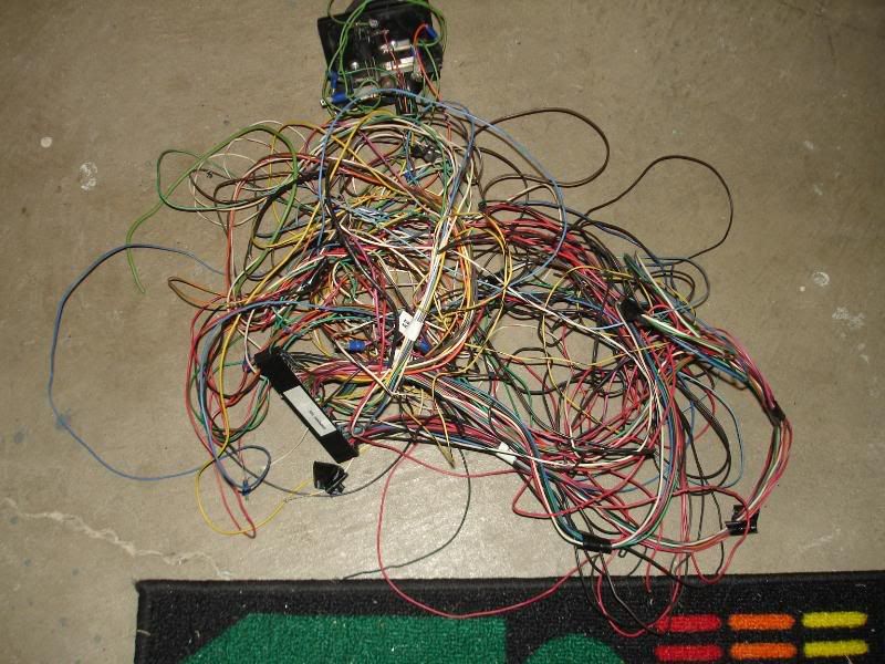

The wiring was a disaster ....jamma wires all over the place and no organization.

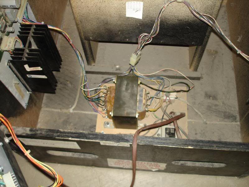

The original Iso transformer was intact but the wiring hacked to shit...

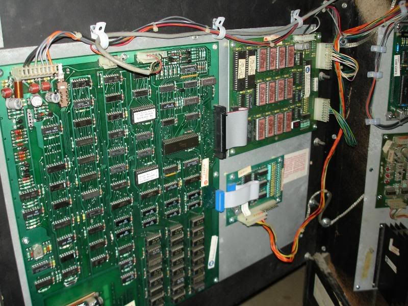

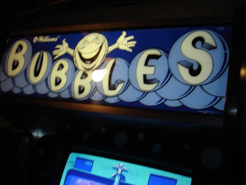

I started by finding the missing parts I needed. I located someone with a complete working set of boards and metal backing for both. They also had a bubbles marquee and spare joystick and some parts

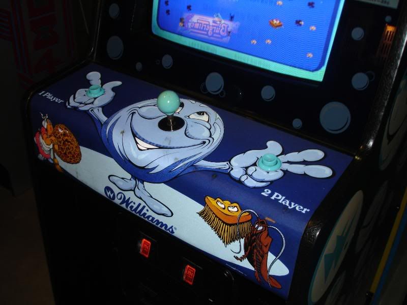

I decided to use the existing fully wired control panel I had from the other complete bubbles that I was going to repaint at some point..this way I could just use the converted control panel and install a NOS bubbles overlay I located and make it all new when that cab restoration was completed later in spring...only thing I replaced on this control panel was buttons with new clean ones. I gave this overlay a good cleaning with magic eraser and then after countless cleanings shined it up with some secret stuff that gives these cpo's a nice shine that lasts a long time. There are some cigarette burns but the flash makes them look worse..the overlay is really in very nice shape.

Once I got all the bugs worked out the game and got it boot up I found a few bad 2114's..big surprise..but after that it fired right up...
I found out that the transformer on marquee lights was bad as it blew out a nice bulb...
hate when that happens...no worries..I have a box of nos ones I picked up..about ten minutes of rewiring and I save original marquee light assembly with nos tranformer and marquee lights up...

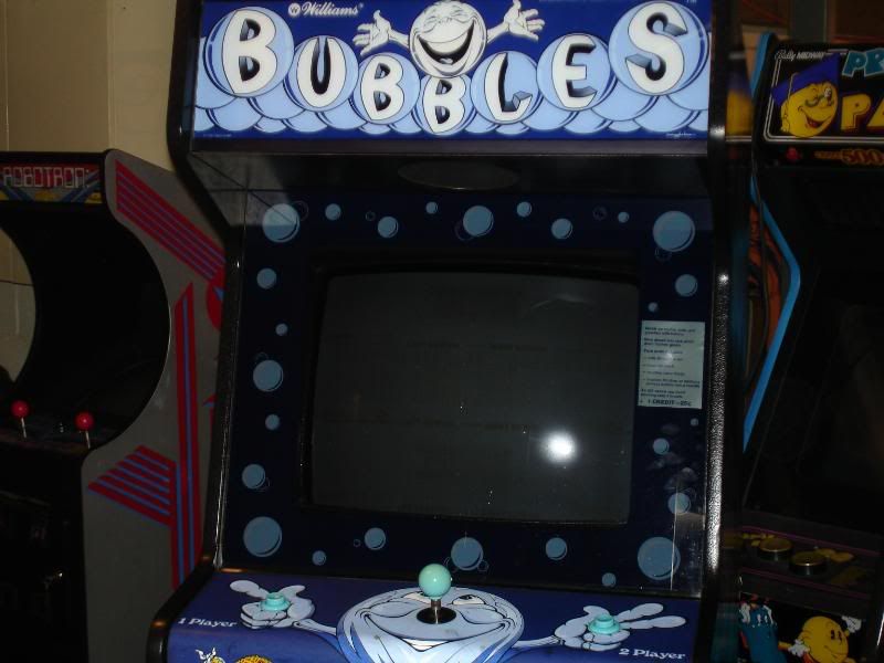

Final product turned out sweet ....
I included a picture of the wiring I pulled out...I actually found some of the plugs for original bubbles that I was able to salvage..but most of it was just a large tangled mess..
