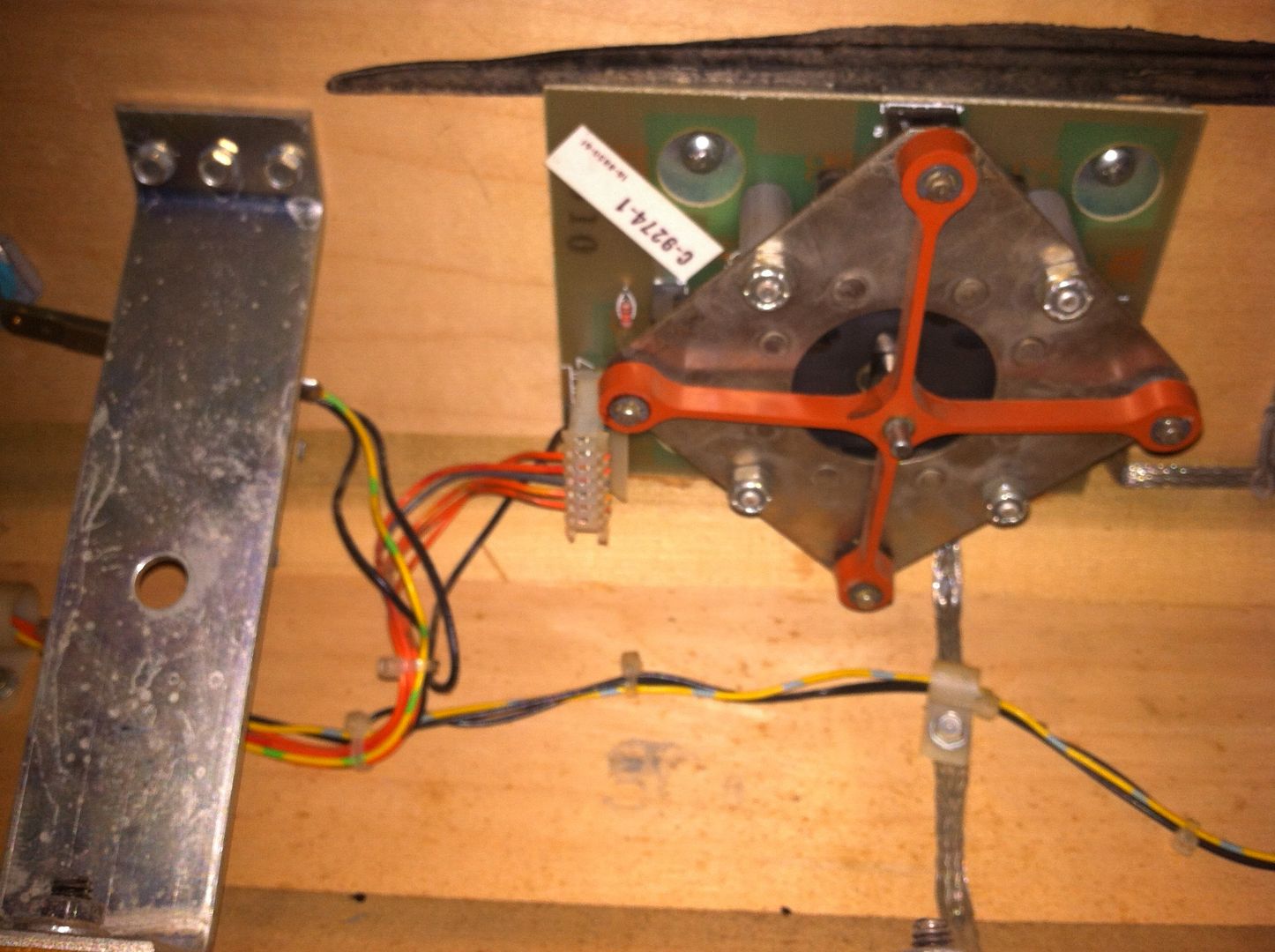

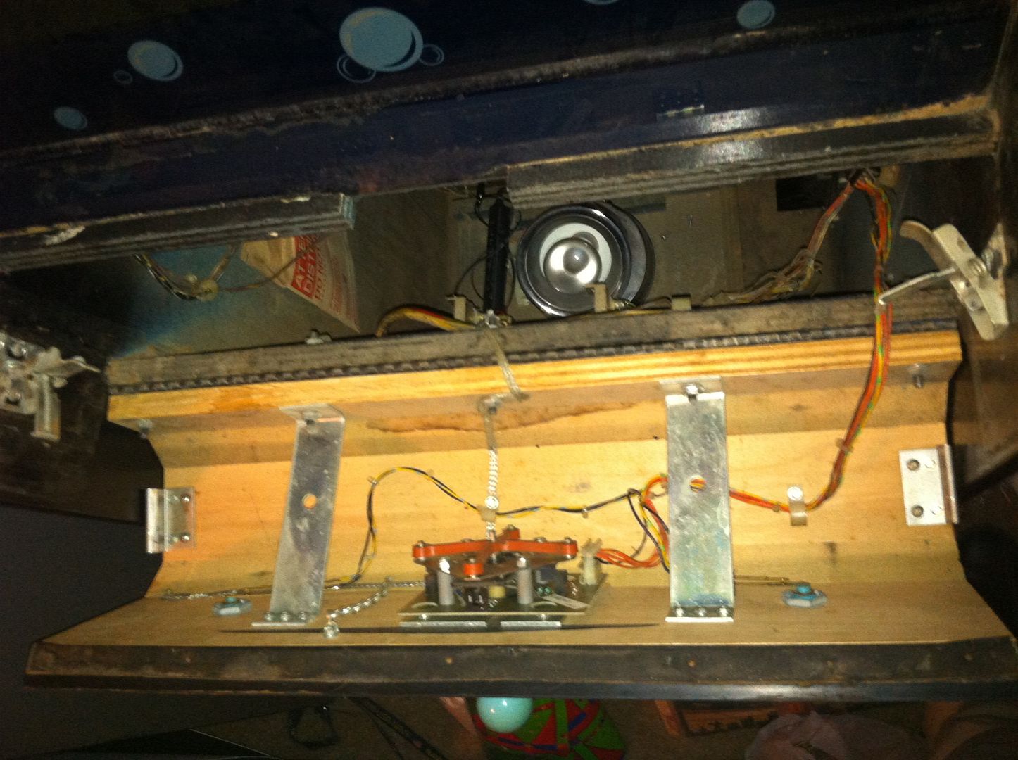

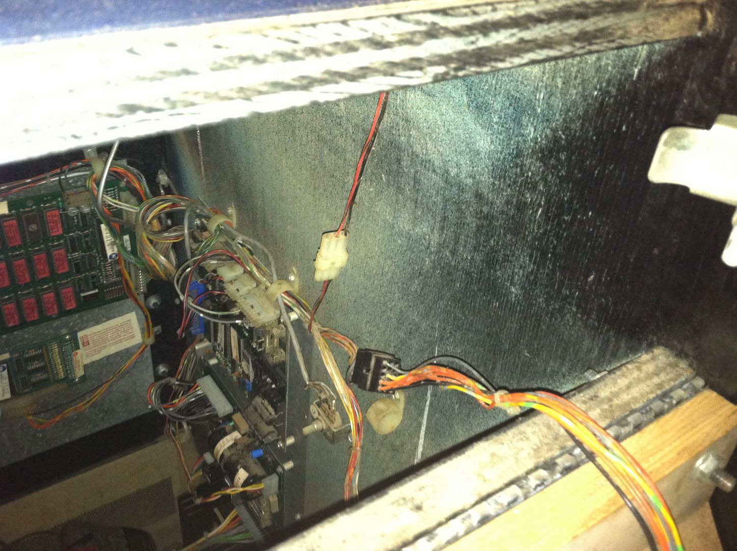

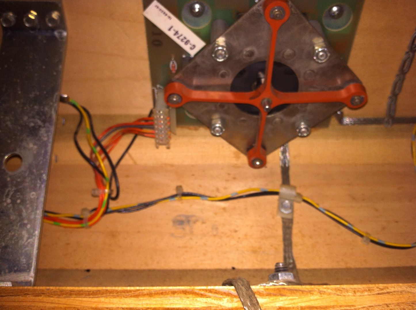

I took a few of mine, it's unrestored (which also means it's dead), never touched best I can tell. Let me know if you need anything else specific:
Joey, THANK YOU. That should really help. Boy, didn't even think about metal braiding for grounding the metal. The chain is interesting. What's the purpose of that?
And yes, there is something else I need. Your optical joystick! You surely don't need it since your game isn't working, right? ;) Seriously, I think this is enough, but if I have any questions as I work on this, I'll let you know. Much appreciated!
I'll need to see if I can find another one of those support brackets. Mine only has one.
I have that chain on a few of my williams cabs.. It makes it so the panel does not drop down all the way..

Oh, I get it I think. So it looks like Joey's is cut then, right? Should be longer and screw into the inside of the cab under the monitor shelf I guess?
The chain attaches to a hook.. You can see where the hole is drilled on the black part of cabinet under marquee.. Hard to tell from the pictures the chain may be missing some length... Basically I think it was designed to protect the control panel when you open it.. It keeps the panel from dropping all the way down.. I Have seen a few wooden williams control panels where the wood has seperated. I believe that happened when someone unlatched the panel and it dropped open to fast..
+1, you hook the chain up so you can freely open and close the coin door. if the chain isn't hooked the door will hit the cp when opened and/or visa versa.
the chain should always be hooked up when closing up the cp (latching it closed), so next time when you unlatch it it doesn't fall all the way open while the coin door is open.
edit: it looks to be the right length it's just ment to hold it open enough to hook and unhook the chain.
