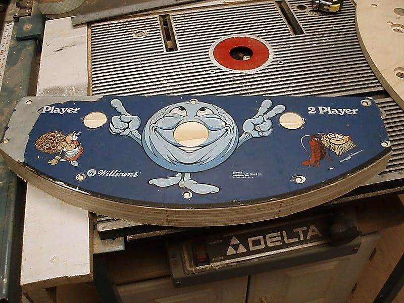

I am going to start a full restoration thread in that section soon, but figured I would post this for now.

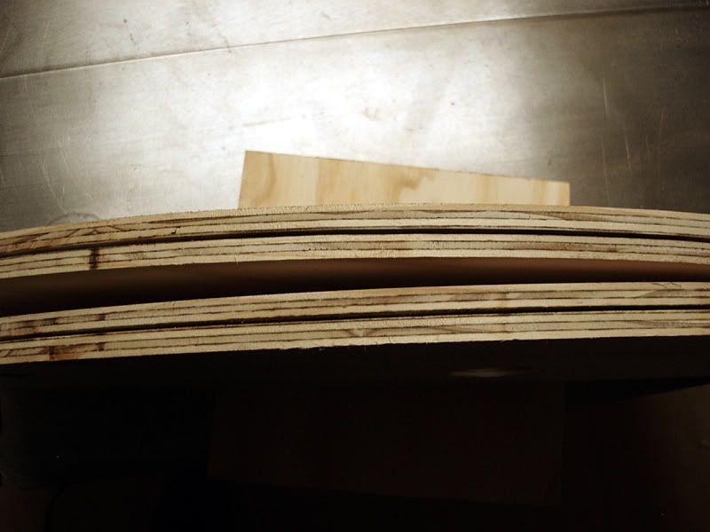

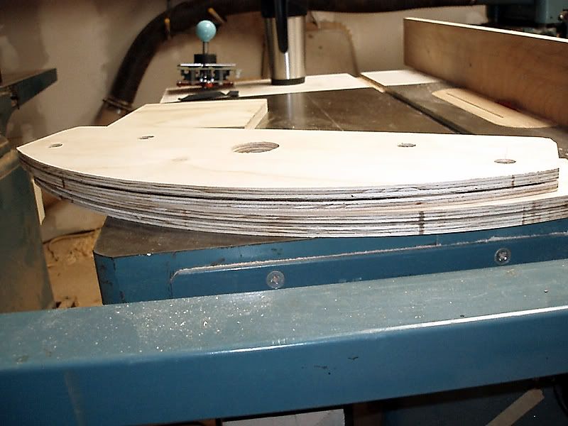

Here is the anatomy of building 2 Duramold CPs from scratch.
This is from uncut wood, to finished product. Even put in the holes for the lock downs, though I am not sure they are pictured.
Once I get the art, I can move forward putting a CP together and adding the tmolding.
I got wood!

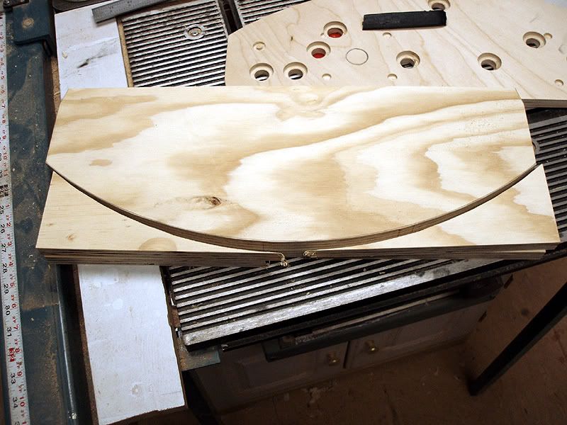

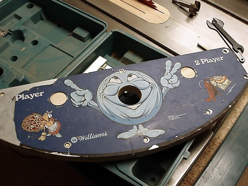

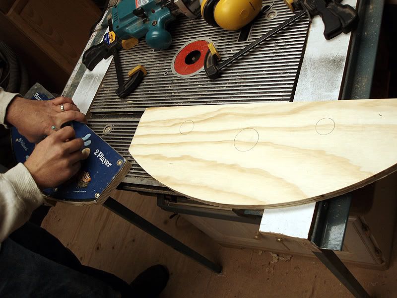

Tracing the Overlay (which is metal?...lol)
Ready for cutting
Cut
Looks good, but needs some trimming

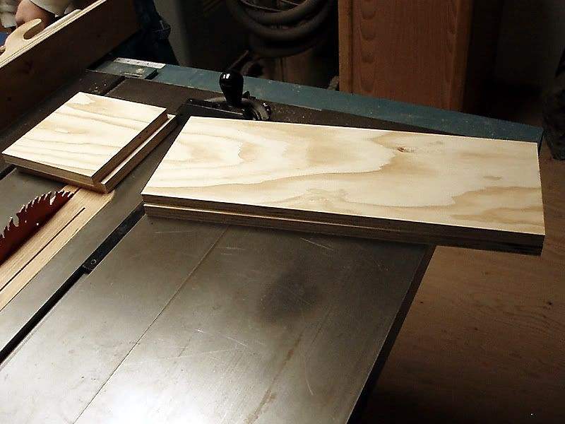

5 pic limit, so this will continue inline.

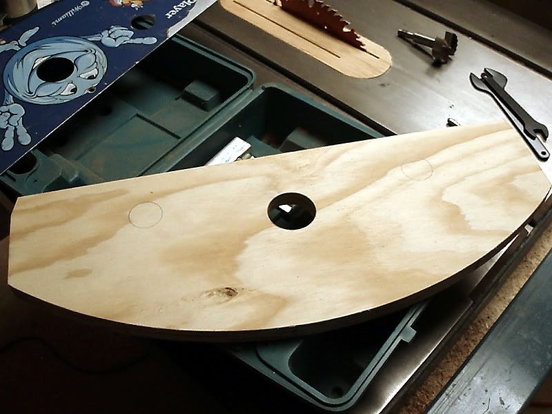

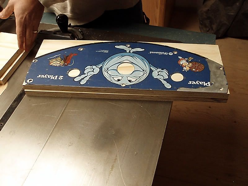

Trimming

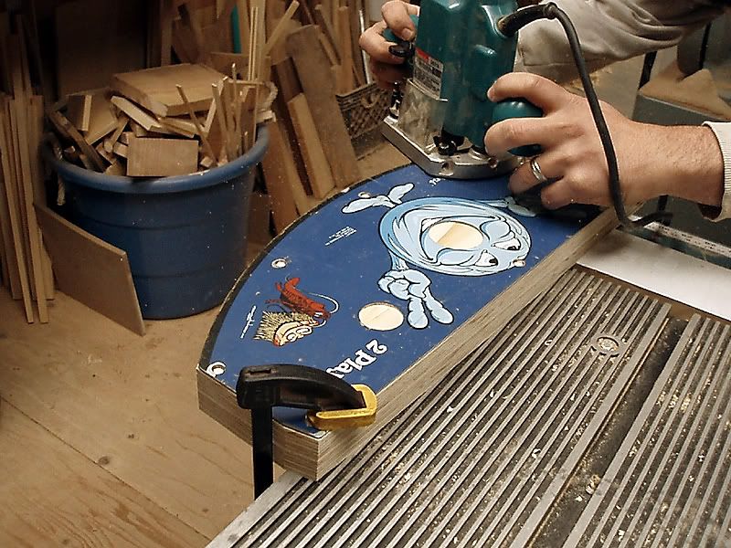

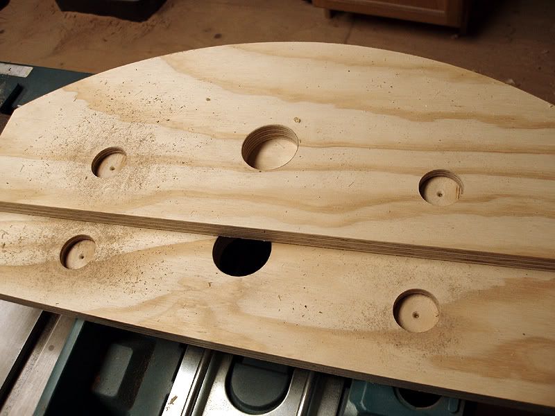

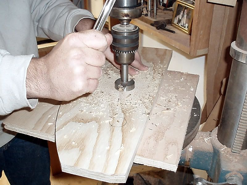

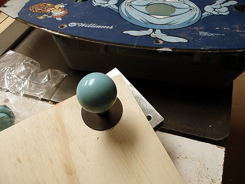

Marking Joystick hole
Test Cut for joystick
Drilling Joystick hole
Done:
Perfect fit!

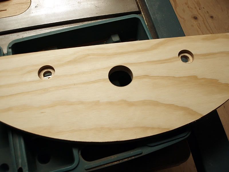

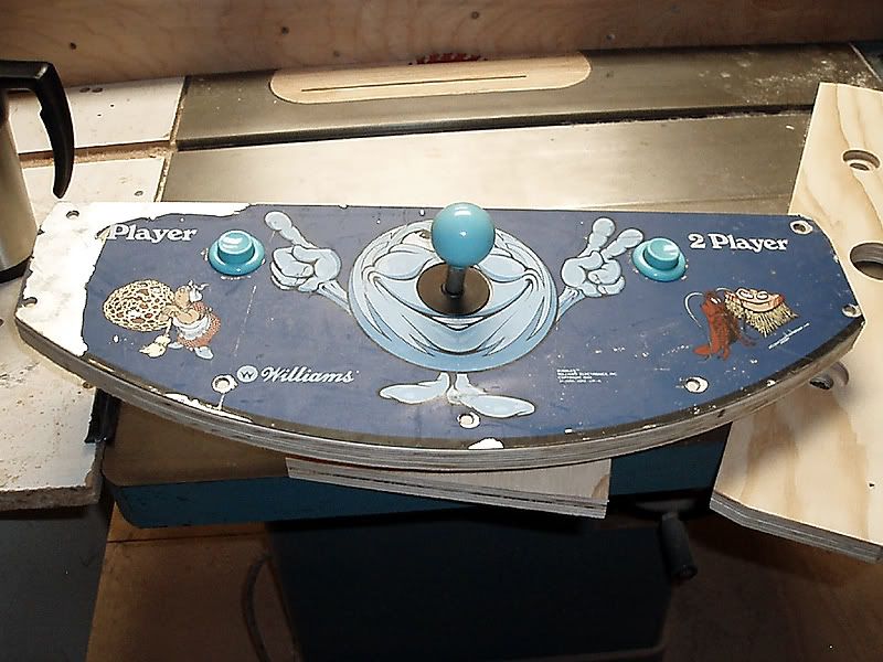

Marking button holes
First level of button holes drilled
Second level of button holes drilled
Cut t-molding slots!

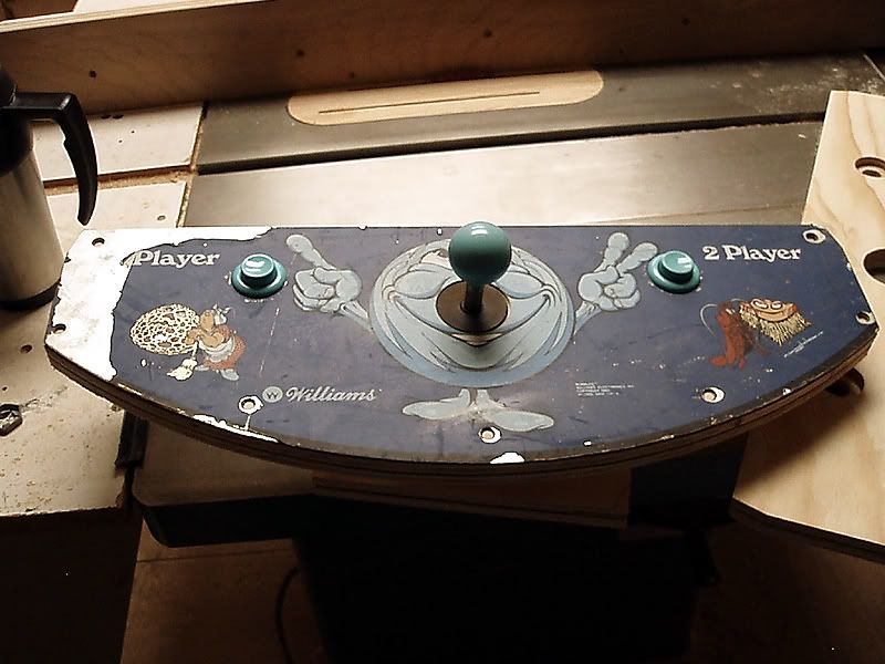

CPs after everything has been done
Everything fits!
Looking awesome!
Sorry, didnt get pictures of the lock down holes... next time!
We finished 2 CPs yesterday in about 40mins! He could have done it in half the time if I was not there...lol
