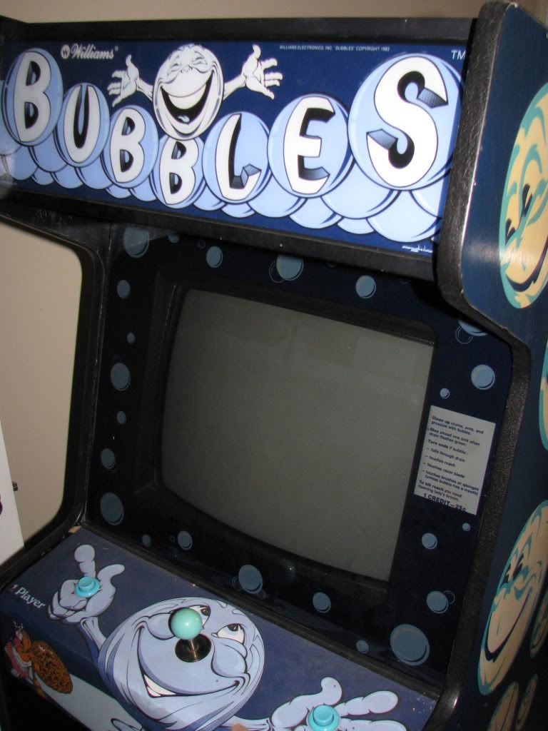

Almost there, just need to finish the side art:
Step 1: Scan all the art:
Step 2: Put the puzzle back together: (the biggest bubble #2 took 4 scans)
Bubble guide:
Step 3: Redraw all the bubbles in Adobe Illustrator (this is the step i'm on)
Step 4: Measure and line up all bubbles in correct position on cabinet
Step 5: Option to print as solvent inkjet, plotter cut ready to apply or create stencils
The artwork and process are exactly the same, just reversed. I haven't had the best luck actually painting stencils, the tiny details are very challenging.

I respectfully disagree. Although doing it up vinyl would preserve the 'art' of it, I just don't think it would look 'great' on a wood cabinet. Looks like someone might have started on this, but not sure:

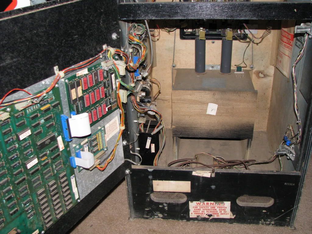

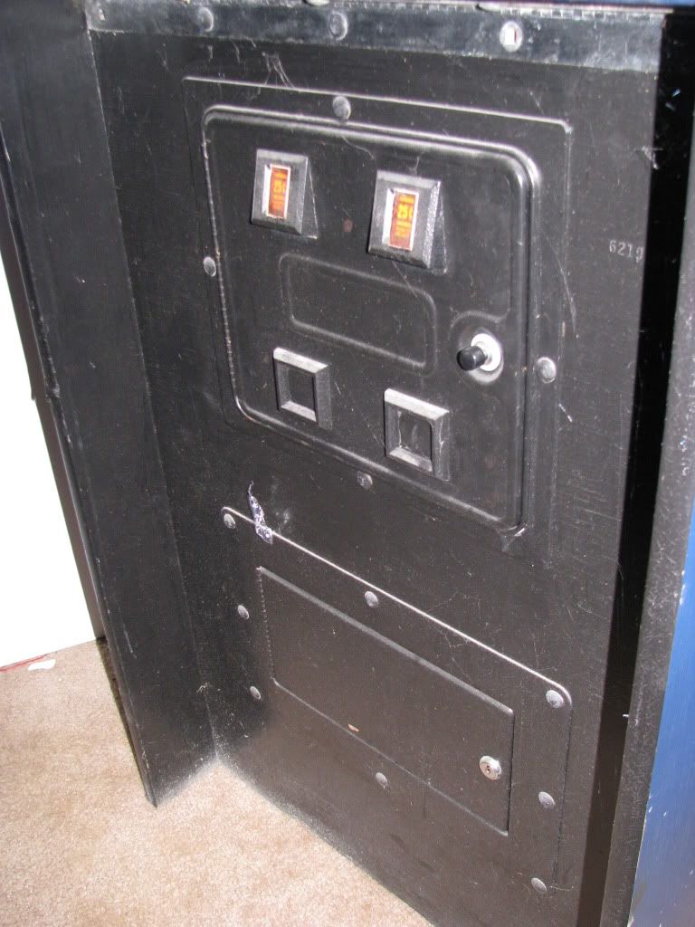

The only modification from original I've done to mine is rebuild the p/s board and replace the associated connectors with crimp pins/housings. A few shots of mine, not currently working:
