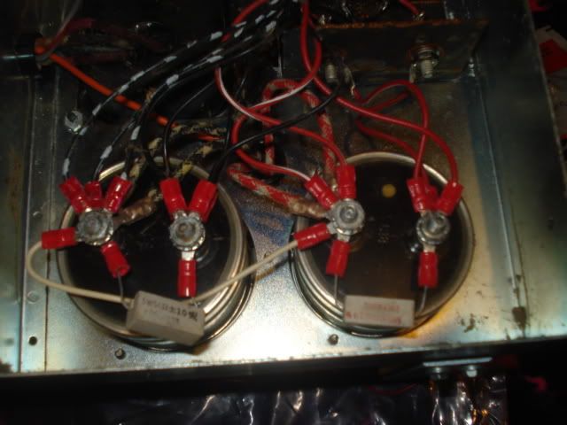

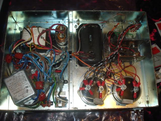

Opened up the Transformer.... I dont see any Diodes - i do see, coming off the caps, two 5 watt / 50 ohm + 10 ceramic resistors - see the pics...
Is that "normal" / supposed to be there? If not, what is the original and how do i hook it up?

Looking at an old post from KrakerJac, he suggests checking three things at the bottom of the transformer:
The big caps should be a value of 55000 and 100000 (not sure how to check that)
The rectifier. Meter test - But i dont see a rectifier!
The diodes (there are 4 of them). I dont have them either....
Anyone that has been in the underbelly of a Bally Power brick - does mine look way off? Anyone have pics or suggest how mine should be? Thanks.
CDJump pointed out to me the MR1120 diodes (above the big caps) are whats needed to be looked into....
Maybe i should just replace those and the big caps.
