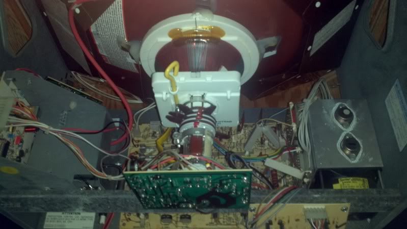

Well, I didn't believe it until I saw it, and pictures of the cabinet will be to come, but the gentleman won this in March 1983 from some "Halfsies" promotion/contest. It has the official letter from Sega in it still and the game was kept in a house and climate controlled storage for the past 28 years...
It really is new. All the documents/flyers were inside on the back door. The game has never been used because...he tried to play it and the monitor never came on.
Hence THESE pictures:
http://i73.photobucket.com/albums/i217/DreamTR/2011-06-21_17-20-34_185.jpg
http://i73.photobucket.com/albums/i217/DreamTR/2011-06-21_17-20-29_661.jpg
There are some weird blocks on the chassis that make me believe someone tried to repair this but he says he just didn't bother with it. The fan doesn't have a speck of dirt in it. The game is immaculate, no smashing, nothing. It really is brand freaking new. I could hear the game playing (as I think they had it on free play when it came to them)
If anyone has any idea what I should be checking on a G08 monitor like that please let me know....I know I don't want to burn down anything, but this thing is silly looking...I think only the estate sale Joust comes close to this thing in condition but it's definitely the first "non" use 30 year old machine I have seen.

That one power resistor in there shouldn't be just hanging there like that.
It should look like the other setup on the opposite side.
I'm curious if it broke loose or if it was just installed half-assed.

kstillin: The two hanging bricks you are referring to? When you say "other side" are you referring to the brick that does not look like it is cut in half? Both of those things are just hanging there.
Those Bricks are Power resistors and get Hot to dissipate heat. Their are usually 4 of them, 2 pairs soldered in series and in a T-Pee shape with white goop on the center solder connection to protect from shorting out. They should be side by side like in the picture below. In your picture it looks like someone connected one pair with wire and left it laying loose on the chassis which could have shorted on something. It looks like someone had been trying to work on it. They did have to make modifications on the G08 monitors back in the day. Maybe this is one that got shipped before they finished.
Should be an easy fix. Great find.

Ah yes, the infamous broken tee-pee resistor network.
Here's a memo about it (though I don't think their recommendation to "piggy-back" would have given them the resistance they were looking for, so it was a fail on top of a fail). I also love the "come to know and expect from them" line, though I have a few memos from Aladdin's Castle complaining about G08s, so I suppose that line is warranted.
After this problem was noted, going forward the tee-pee resistors were globbed with some sort of caulk/glue (ah, I see someone posted a picture of it).

Sure looks like fixing that resistor teepee will do the trick as well. makes perfect sense that's what kept it from firing up!
I recommend you consider the notes at William Boucher's site - he has some nice notes on Star Trek:
William's GO8 Notes
Replace the 'teepee' with these 2 parts:
3 ohm 20W ceramic from Digi-key
And before you apply power to the G08, even though it is virgin, read these notes carefully:
Mongo's Simple Sega G80 Vector Mods
...and at least do the power transformer mod to protect your monitor (toward the end of the document). It is easy - you'll spend more time verifying everything than performing the mod.
Good luck and take your time. Oh, and get a multi-Sega kit!
