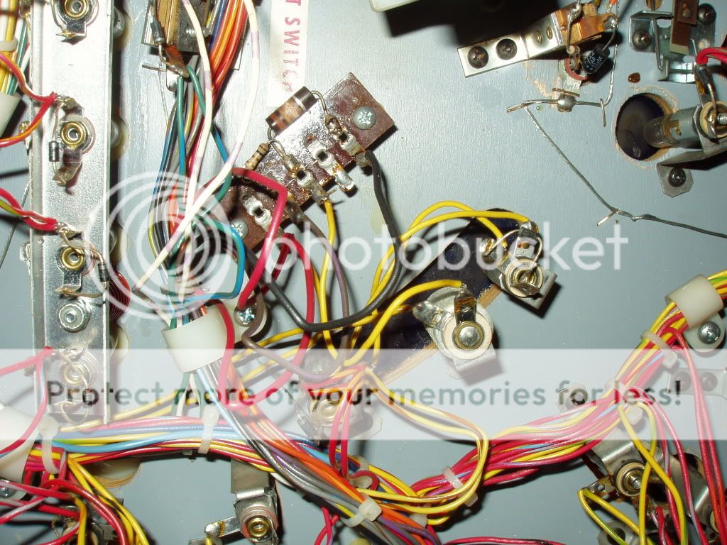

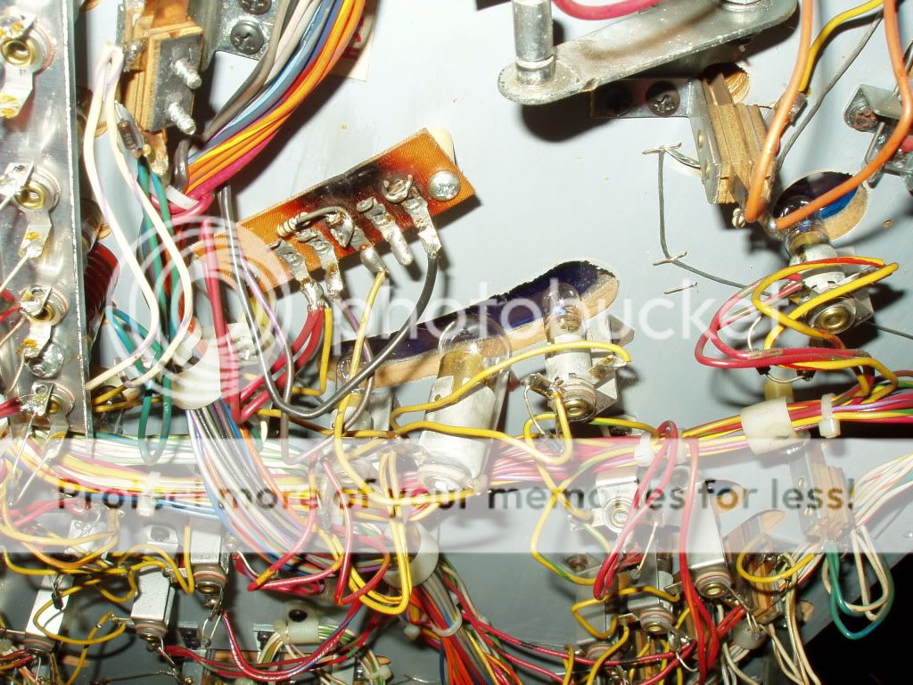

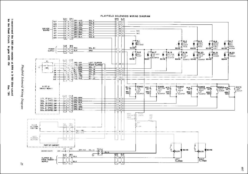

Underneath the playfield there is a little terminal strip that has two resistors on it. It is not in the regular schematic, but on an extra documentation page 4. These resistors are 8r7 and 8r8. 8r7 is a 1 ohm 1/2 W resistor that carries the current to make the bulbs flash bright. 8r8 is 330 ohm 2W resistor to keep a small amount of current on the filament to keeps the filaments warm so that they flash quicker than if they were cold. (or so the theory goes) On most Firepower machines these two resistors are burned out and the flashers do not work Replace 8r7 with a 1 ohm 1 W(or highter) resistor. And replace 8r8 with a 330 ohm 5W (or higher) resistor.
The extra schematic page is here:
http://i633.photobucket.com/albums/uu54/co_goose/Pinball/FP-extra-4b.jpg
and a picture of the board is here:
http://i633.photobucket.com/albums/uu54/co_goose/Pinball/FirepowerDuring015.jpg
the 1 ohm resistor is cracked, and the 330 ohm resistor is missing, but that should get you the location that you are looking for.
Found a better picture:
http://i633.photobucket.com/albums/uu54/co_goose/Pinball/Firepower2During034.jpg
This one has both resistors in place and the 330 ohm pretty shot.
