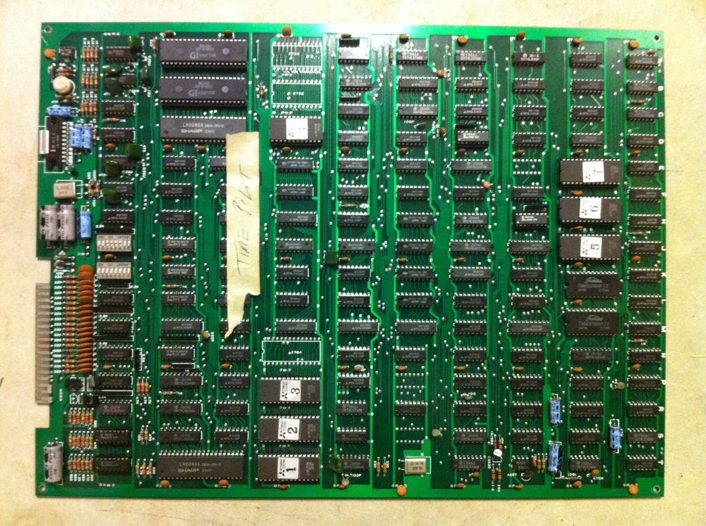

Bootleg Time Pilot PCB?

I have a PCB marked as a Time Pilot, but it's obviously not a genuine Time Pilot. Does anyone recognize this as a Time Pilot bootleg, or is it mislabeled?
Looks like standard Konami Classic pinout to me.
I've run across a couple other bootlegs of early 80s Konami games (not TP, yet), and they've had the regular Konami pinout.
I think you are correct. I poked around with my multimeter and it does appear to be Konami classic pin out. I'll have to build an adapter so I can test the board.
