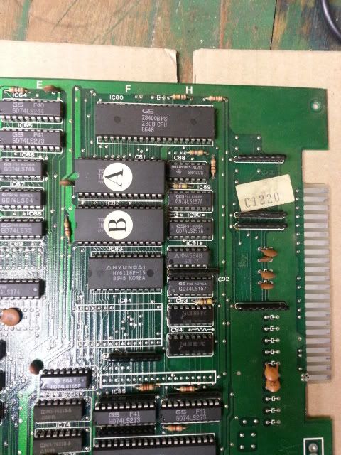

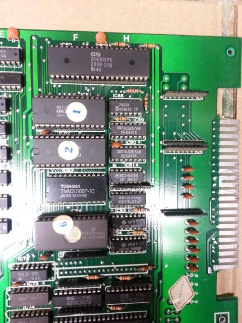

As you can see the Roms are Numbered on the one that came in the Arcade and the one I bought is Lettered...

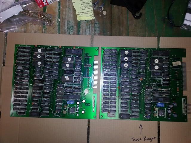

Doesn't look like your missing any roms man.. Both pcbs are arkanoid bootlegs.

That is very nice of you to offer this, when looking at my picture you can see the numbers and letters, the one I just bought you can see on the right side A , B, rom and then a missing one.
On the other board that came with the machine its clearly 1, 2, rom, 6
<--- Board I just Purchased !!!

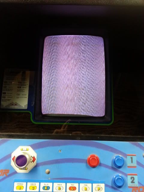

What the screen looks like with the bootleg board I just bought !!!
I hope that is not a pic of the 'working' board you just bought, is it?
Yes sir it is.....
So I swapped bootleg to bootleg, seller has a return policy but I want to make sure both bootlegs are the same.

Re check ALL wining with this pinout to make certain that all voltages and connections are correct. I suspect a syc problem....Note #4 is a neg. sync....
The new board you bought gets its power from that connector next to edge connector (like a real Taito board would). Your old bootleg board has the power routed to the edge connector.
Also, your new bootleg board does not use a microcontroller at IC84 (what you are calling ROM 6 on your other board), so that is normal.
Heh, like I said.. No missing chips.. If it was you'd have empty sockets.
Matt knows his shit when it comes to arkanoid. You'll have to modify or make a new connector for the new pcb you bought. As its not a direct swap. I'd bet it works just fine as the seller stated, unless because its not the same pinout you may have damaged it.
