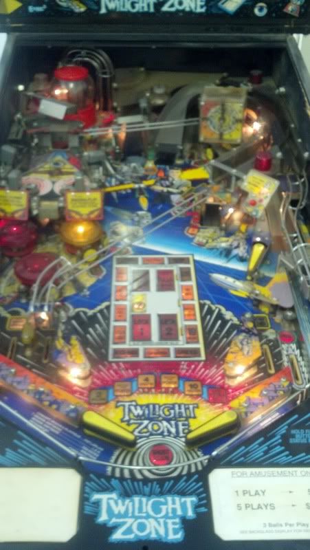

I got this from the owner of a local dive bar here in town who really wanted the money to put towards a Harley Davidson machine. I spent most of the day cleaning the playfields. There was a thick cake of dirt over the entire thing. Novus 2 and a power drill cleaning kit cleaned it right off!
Honestly, the guy never should've owned this machine. He seriously neglected it - all the optos are out, and the rubber rings are literally so crusted over, they'll probably break if you touch 'em.
Maybe all that dirt helped to protect the playfield.

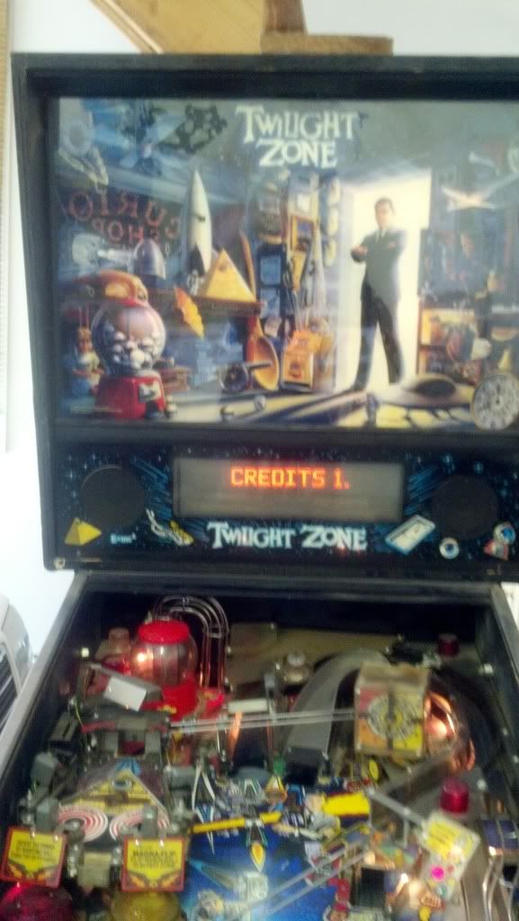

But as you can see by the credit dot in the picture, the game needs serious repair.

Right now, I'm getting the fun filled "Ball popper optos are stuck" message, but every opto on the machine seems to be out. I took a multimeter to the opto board and alot of the resistors on the PCB are dead. Plus I'm gonna change out the LM339 chips while I've got the board out.

I installed a new opto board from Great Lakes Modular, and all the optos work except for the ones in the auto shooter. The 'Ball popper opto is stuck' message is now gone.
But the game is now playable. But until I replace the optos in the shooter (parts have been ordered), it doesn't fire the balls into the gumball machine.
After I repair the optos, next on my agenda will be to buy a new clock PCB w/LED's. My current one works when it wants to, but it does not light up.

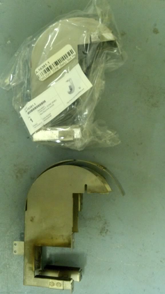

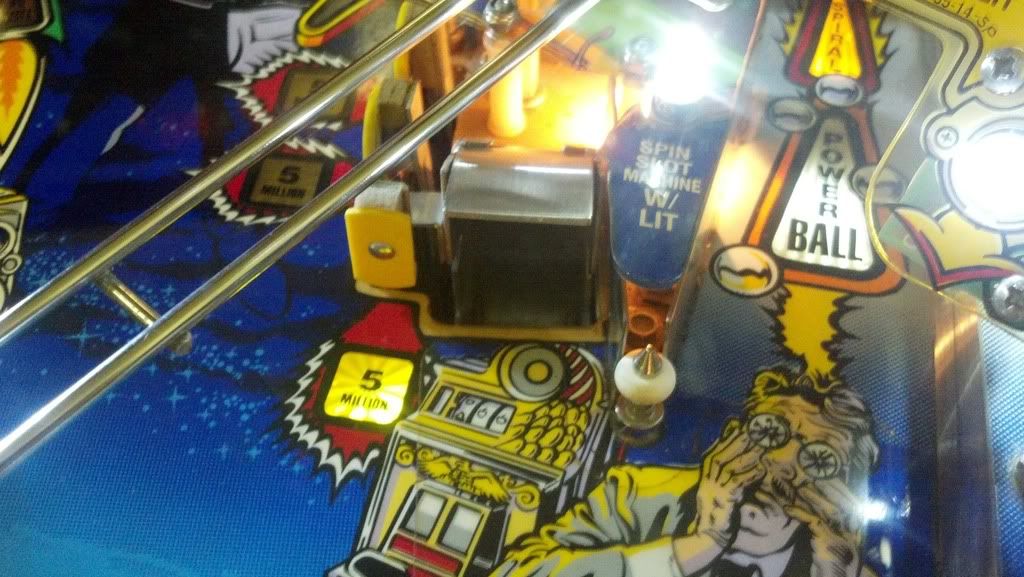

Some parts arrived today.
Installed a new slot machine scoop and a reinforced greed target. My old slot machine scoop and target were totally trashed.
The target was so bent out of shape, it basically acted as a spring, and sent the ball airborne 90% of the time. The new target is a godsend. If you have a TZ, I highly recommend them. The new slot machine scoop designs also add another layer of reinforcement foor the targets with a bar that runs behind it to prevent it from bending.
