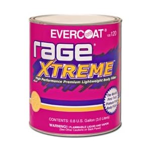

This is what I have been using recently:
