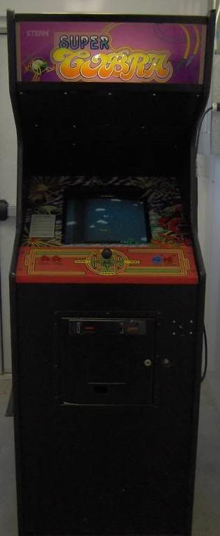

Awesome...I am in the midst of doing 3 in one (Got a Scramble cab... a Super Cobra (currently in my Contra machine..and that just looks bad) and a Time Pilot board). Have a switch and the cables..just need to get a few 36pin connectors to get the job going! :)

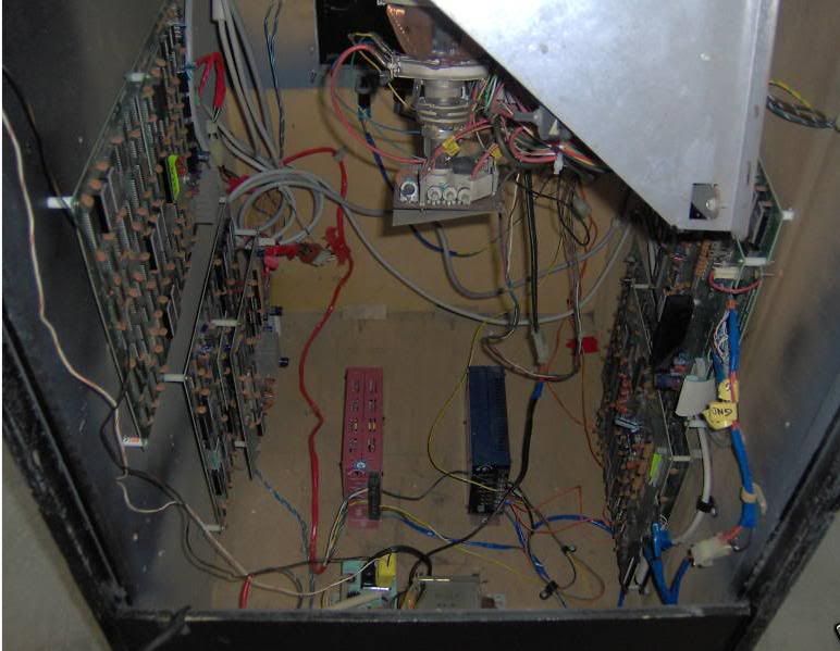

There was a Super Cobra cab on eBay recently that had 4 boards in it with a rotary control on the front of the cab to switch games. Looks like a neat way to set it up.
From the eBay listing:
Hi Folks! This is a Stern Super Cobra arcade game cabinet that houses four different games. The four games are Kicker, Time Pilot, Time Pilot 84 and Gyruss. The games in this cabinet are original and work 100%. There are four original boards in the cabinet that are custom wired and are controlled by a dial on the front of the cabinet. You simply turn the dial to the desired game you want to play. The cabinet is in excellent condition. To get a full description of these games please check them out here:

I guess all that you would really have to switch is the power for the boards. I would like to make it as unobtrusive as possible. Not mod the cab or original harness. I would llike to be able to undo what I do. I'm thinking that I could make a 4 slotted circuit board with an edge connector for the OE harness to plug to and go from there.
