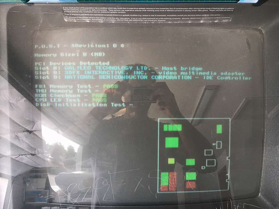

Hey guys, picked up a Blitz a week ago and getting to restoring it now and when you power it on it runs its tests and gives me a TMU Memory Test Fail (see pic below). It also seems to highlight some PCB chips in red, maybe saying they are bad or something (also see pic). Can't seem to find any info on this error, the game seems to play fine but definitely want this fixed.

I had the Exact Same error, Mine was that the Actual TMU had became disconnected on several pins. I sent it to a guy and he re-flowed that TMU. Works great now.
Board flexing crappy handling bumping the Fins on the TMU can cause the pins to de-solder or break loose from the Pads.

Thanks for the info. I will take a look at the roms and TMU to see if anything needs re-soldering or whatnot.
it is hard to see the breaks on the TMU there Super tiny wires. But I was told to gently flex the board around the suspect chip and if there broke you will see them move around a bit. Focus on the TMU closest to the Edge (the one in red) on the Test Screen.
Darren, well you were right and there must have been a slight break or bad connection on the square TMU memory/chip with the heat sink on it. Luckily for me we had a local arcade repair party today and the famous JROK was in attendance helping people out. I asked him about the board and told him about your solution and he used some desloldering wick and placed it over the pins and then ran the soldering iron over the wick to heat up the solder and use the wick and flux to reset the soldering connections. We restarted the board and the TMU Memory Passed its test!
Hopefully this little trick helps anyone else that comes across this issue, took about 5 seconds and all was fixed :) JROK is an awesome guy, absolute genius working on these machines!
