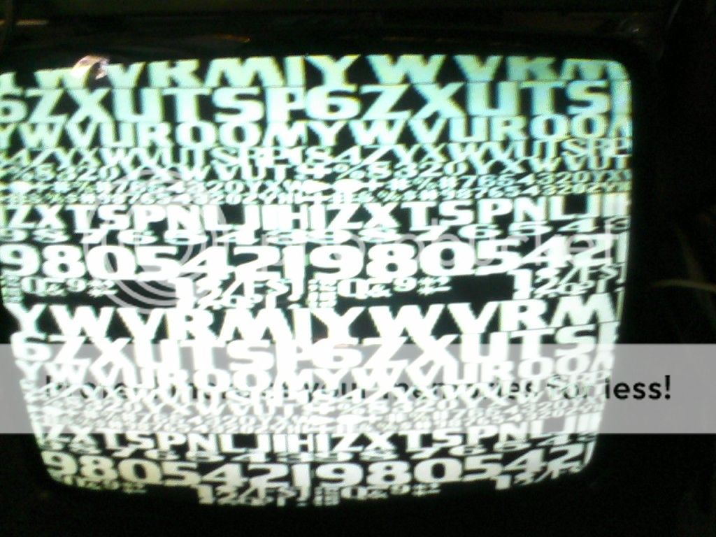

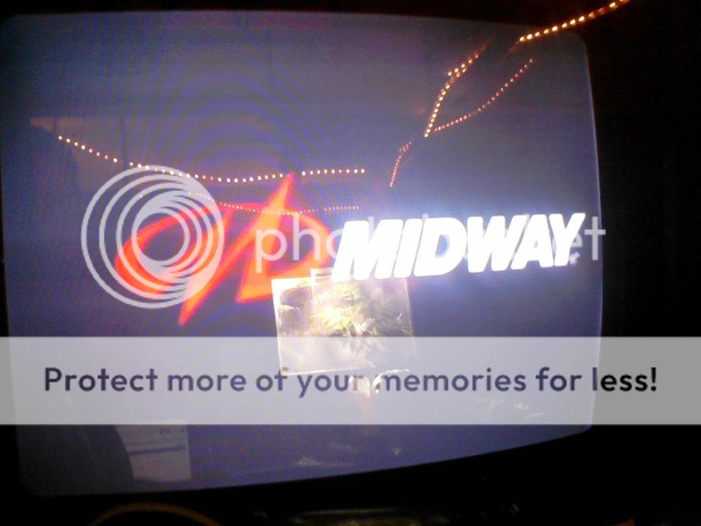

It's fine until it hit's the Midway image, starts for two seconds and then click from the hard drive and all the sudden the alphabet is on the screen over and over.

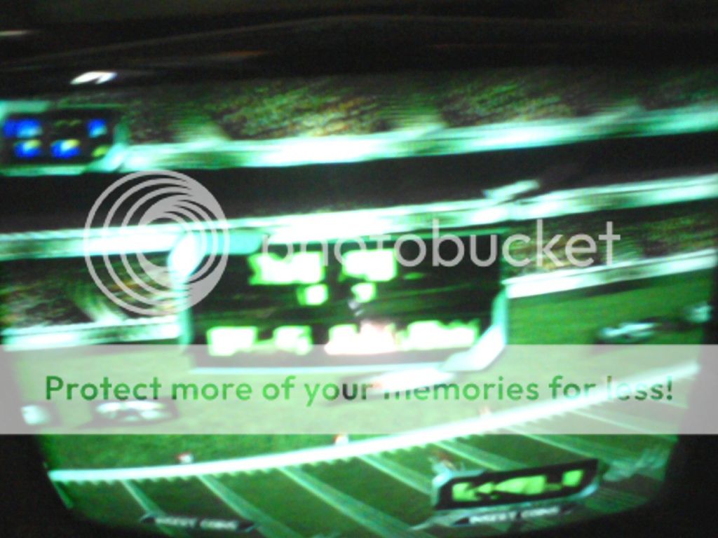

A vast majority of the graphics are fine. The Blitz logo on the field is faded out and some of the lettering is blocks (near the top of the screen). I'm not sure what could be causing this?

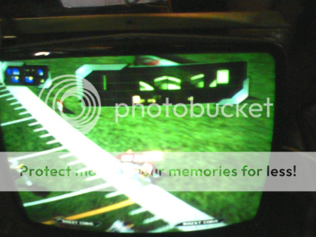

At the very beginning of this portion of the attract mode is when the problem arrived (picture imaged is of the scene but without the graphic error)
Here's what actually shown up once the error occurred.
Shortly after it would continue attract mode and you can clearly see the blocking of the letters. Very strange, but i'm glad it's back to normal.

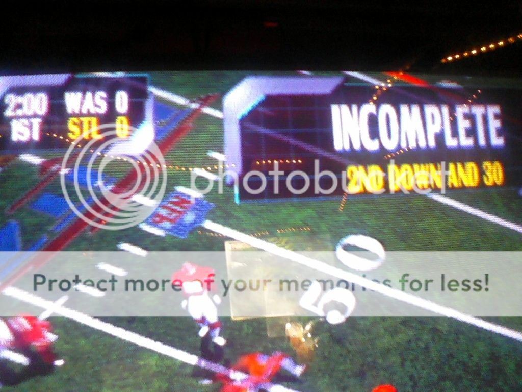

Back to normal once the power was properly adjusted.
