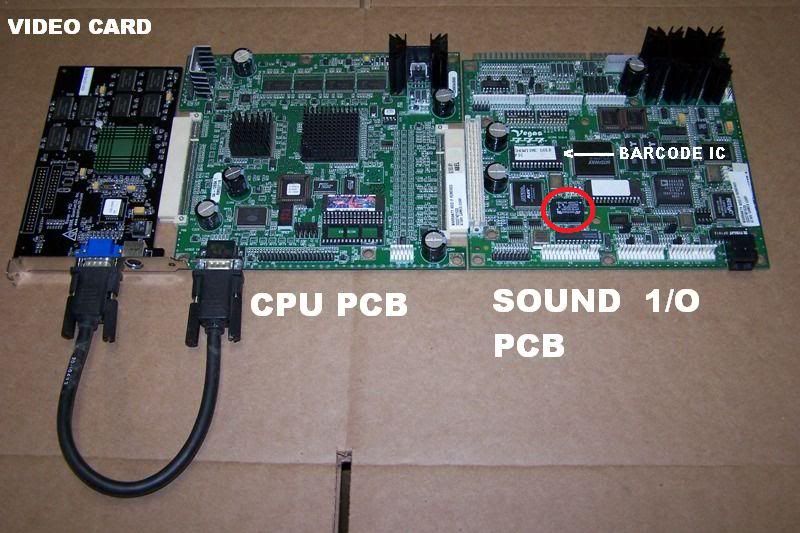

I can't find a hi-res pic of the board online, and the game is at work. I circled it below in this pic:
It is not listed in the manual's 'Field Replaceable Parts"...
BTW - while looking up "Timekeeper" batteries, it appears this is some sort of NVRAM with an onboard battery, and if the battery dies, it can cause all kinds of issues. It also has a crystal inside.

I recently picked up sportstation vegas board setup and have it working on the bench. Howver, I get several errors on POST test for SSIO board. CMOS Batter Low, Watchdog (sometimes), Sound FIFO Fail, etc.
Despite the errors both blitz and showtime are working. Does the lithium battery charge? Any one figure out something on the above?

no, its not a rechargeable. You can buy a replacement. arcade services I sells them(they sell CF upgrades, replacement HDD, and sportstation wiring harness).
http://www.arcade-service.com/parts/eproms-components/
I posted a while back when I found someone selling them for less, so look around and you might save a few bucks.
