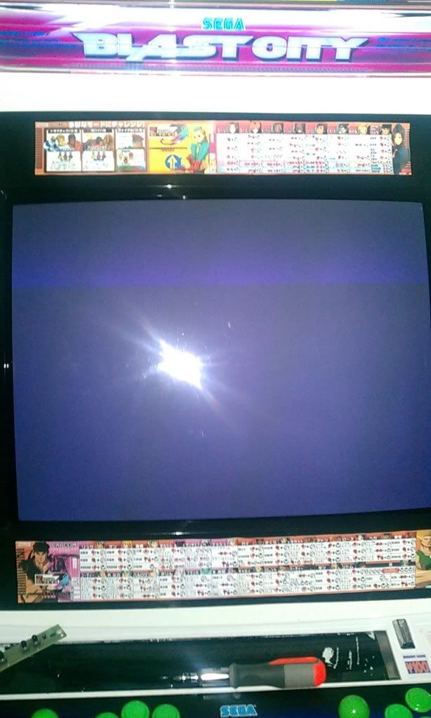

Hey guys n gals,
I am missing the 15 pin plug on my nanao ms2932s monitor and was wondering if someone could tell me the pinout of these plugs (picture below) so I can make something to wire it up.
-Thanks
Edit: Wow it's blurry and big. sorry. but I'm sure someone can tell what they are.
Alright I got the pin out of the 15 pin thanks to Coinop. Now i just need to figure out what the wiring is for picture 2 to hook it up to those..

More info, Do you have the remote board ? maybe more pictures not so zoomed in so we can see what your working with? those wires on these monitors are usually your typical red, blue, green, synch, remote board and then your not so typical power and degauss.
Alright I think I got it, I'm just going to make some new plugs and match what it has on my other cab. I'll let you know what happens....

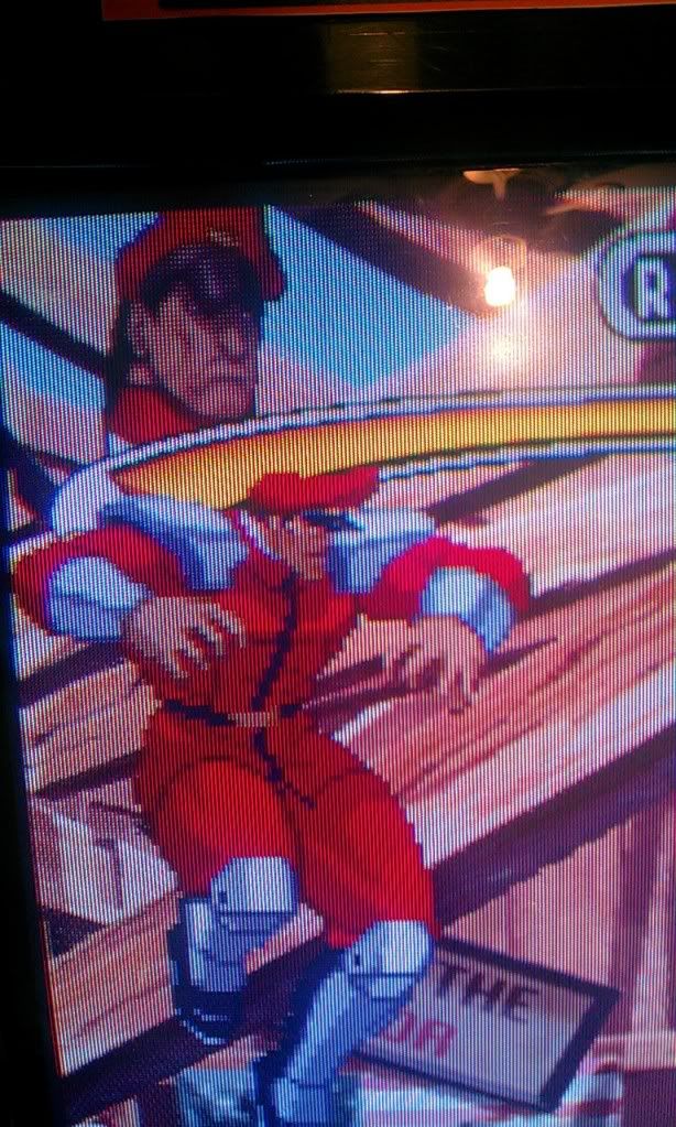

Alright so I copied my other cab and..........IT WORKS!!!
but a new problem arises.....
1.It looks nice
2.But what's that? poor bison...
3.There is some line that runs through the image and distorts whatever goes through. Its up top, see that?
Humm I can't see it
I'm not sure I see what you are seeing but sounds like maybe some bad caps ? My 26" nanao is starting to mess up at the top started with a bright white line and then over time I'm missing about 3/4 of an inch at the top, I'm hoping a cap kit will fix it but I'm just learning monitors. And there is not a lot of help with this brand. I'm jumping into it feet first though I have more monitors then I know what to do with all different brands and models so I'm learning a lot real fast. Glad I was able to help you get it going I'm sure you got everything hooked up correct and don't see how any settings or pots can help with what you are describing. I'm sure it is a defect in the monitor chasie.
