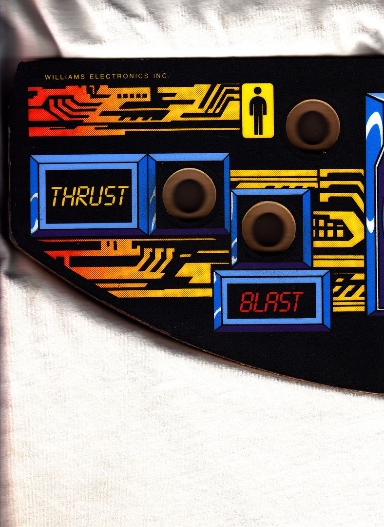

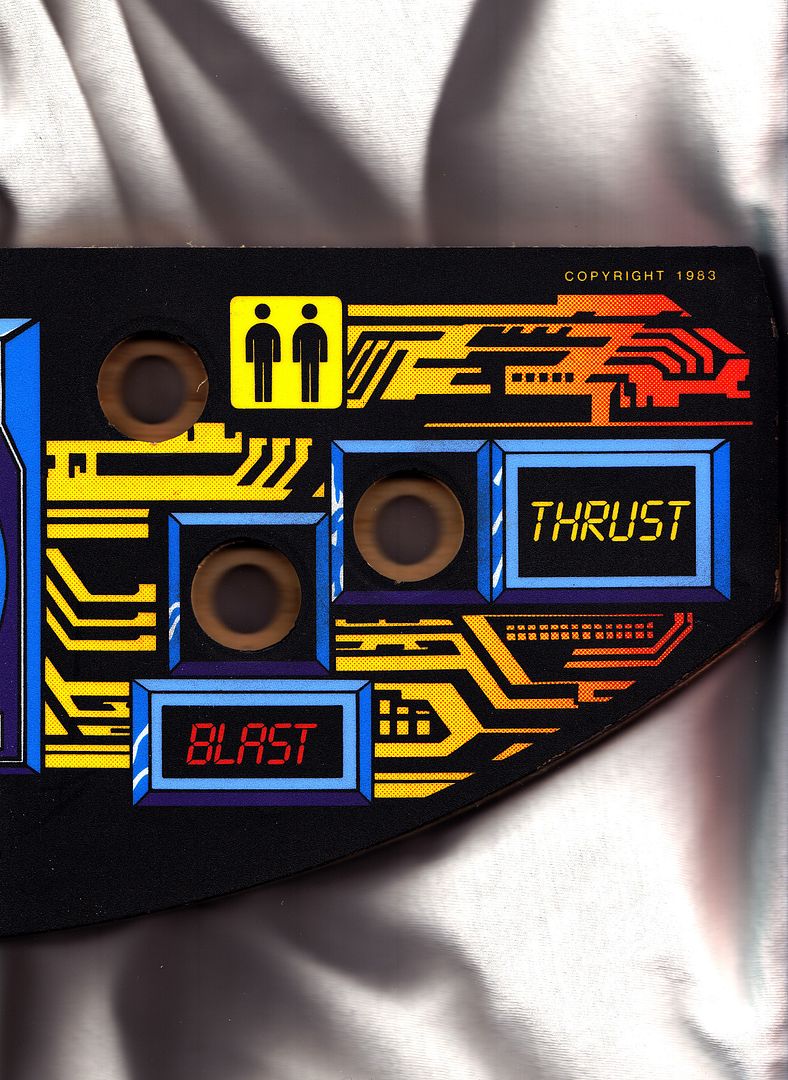

Here are the hires photos that were given to me (had them in a Dropbox backup). I think the printer pulled the final version out of the dropbox folder when they used it (note to self: Private only backups). I'll find the repro I did this evening I hope. These photos were given to me and he ok'd sharing. I need to find his name so he can get the Karma points.
Anyway, hope this helps.

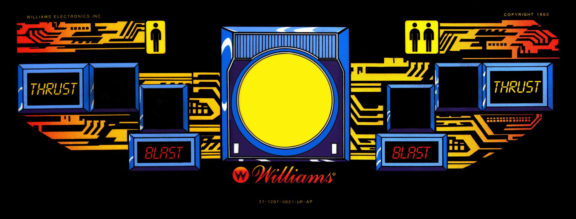

Here is the CPO I did based on the photos. Below is the sample jpeg and a link to the dropbox tif and hires jpeg. It's "blaster.tif". The size should be 21" x 8" at 300 DPI I believe. Also there a hires jpeg of the marquee, though not as good as the ones sold I think. Will grab some photos of the CPO on the CP soon.
I used my meager skills to make these presentable but they are far from perfect. If anyone makes them better or cleans them up further, and wishes to share, please upload them to the DB folder (it's the public folder) and post the update on this thread.
Hope this helps.

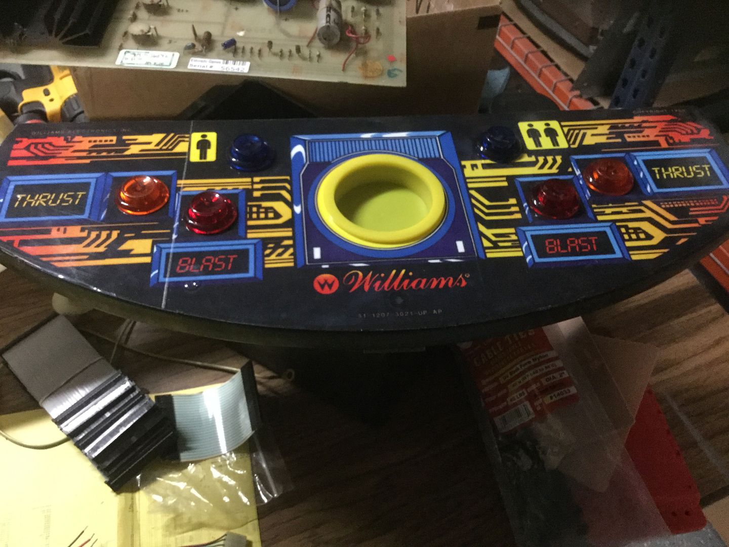

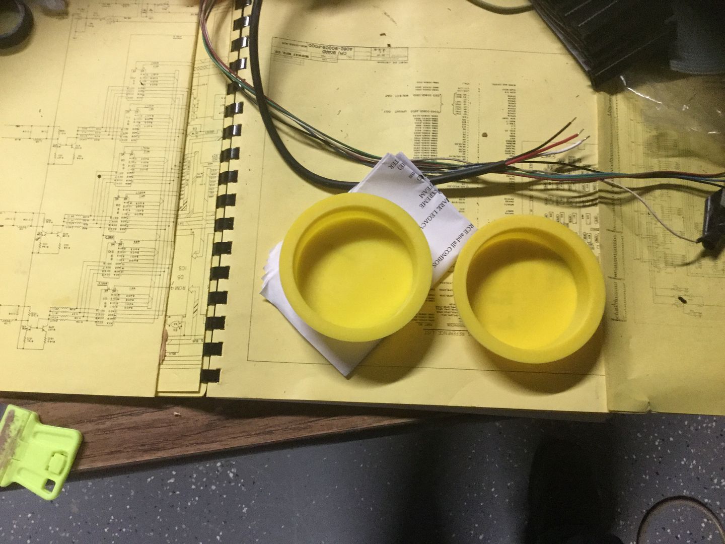

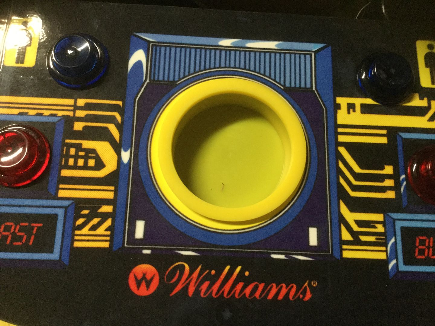

Thought I might post this here for anyone interested. I have been displeased with the 2.75" hole in the CP for the modified joystick cosmetically. Thought about felt but found these (below). These fit the hole exactly and nearly match the CPO yellow. These are MOPAR flanged caps (Exact part: TAPERED WIDE FLANGE PLUGS LDPE YELLOW TWF2.63/2.75YW1 on the MOPAR site). I think it looks very much like a dedicated cabinet part once in place. Still will need to cut a circular hole in the bottom for the joystick shaft but cosmetically much better until repro handles exist. They'll make you buy 10 ($2 and change each) so if anyone desperately needs one for their CP, let me know. I have seven spares, or so.
